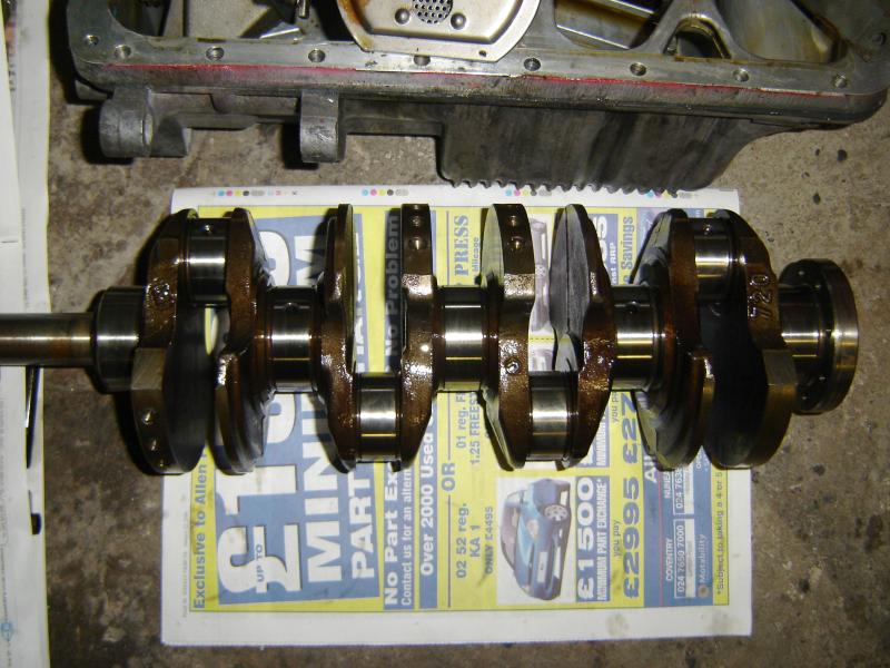

The thin set of counter weights are a bit different on the crank I am looking at (Mi16?) and hope that is just a difference between the S16 & Mi16 crank. I'll have to get a photo up, but yes I think you answered my doubts.

This is my 1.9 Mi16 crank for comparison:
S16 + Mi16 cranks are identical
1.9 Mi16 has a different stroke.

Ryan's photo looks spot on, must just have been the angle of the photo on Dr post.
Thanks guys, big help.
