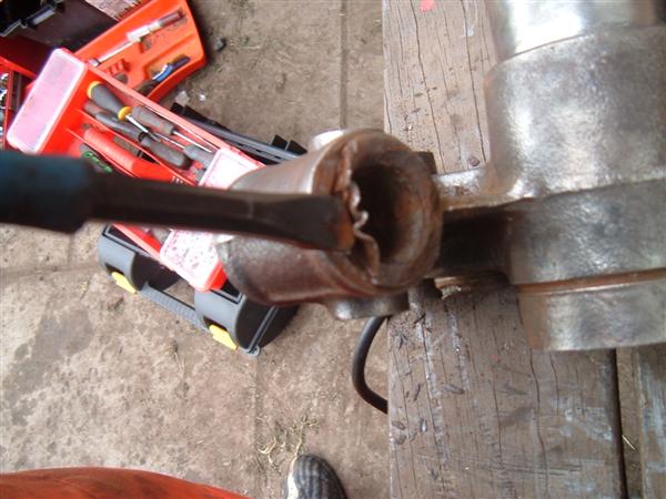

kate205gti
well that wasnt so hard :D not quite finished yet thou ;)
hardest part was undoing the bolts holding the brackets on! they were solid :lol: rubber came out with hammer and chisel/screwdriver which was quite therapeutic and the inner casing got disassembled with a sharp screwdriver and hammer (gave up with the hacksaw!)
only thing now is getting the solid ones in - have copper greased and boshed with rubber hammer, and with proper hammer and bit of wood but they still not all the way in yet :( more boshing needed methinks!
d-9
If theyre not going in smoothly, check that u havent damaged the casting they sit in when knocking out the old ones, its surprisingly easy to put a big gouge in it with a chisel, if you have, smooth it out with emery cloth or a file. If theyre still being a sod to get in, try using the bolt to pull them into place, using washers or sockets as spacers.
Did you clean up the hole before trying to fit the new bushes? I gave mine a good clean up and smoothed it all off, bit of copper grease and some tapping with the rubber mallet and they went in nice and easy.

will try removing and cleaning - then more boshing! :P

what did u clean up hole with anyways? sandpaper wouldnt work would it? not sure ive got a round file
I can't quite remember, but whatever solution we used would have been 100% gypo! :P
Think I just whizzed around the inside with a drill carefully (had no wire brush attachment unfortunately) and used one of those small brushes with a stiff wire end, and maybe some sandpaper. It was literally just a quick ponce about to get rid of any crud.
d-9
Depends what sort of sandpaper u've got, I found some cloth backed sandpaper that got rid of the minor chiseling and all the rusty crud, but if its badly chiseld u might need a round file.
