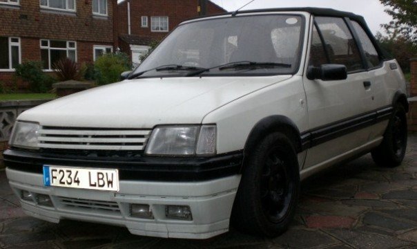

gti-hysteria
i have done it too, it was quite abit of work but i feel it was worth it!!
no comments on the wonkey grill please lads
