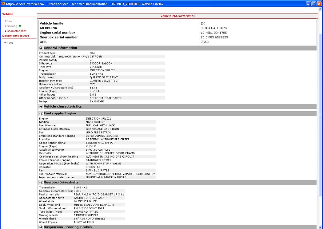

Sandy 191 Posted January 13, 2008 Research-a-thon You can do the same at http://service.citroen.com! Share this post Link to post Share on other sites
welshpug 1,675 Posted January 13, 2008 aaah I wondered if that was possible, do I just select the characteristics tab as in the pic above? Share this post Link to post Share on other sites
Sandy 191 Posted January 13, 2008 Yup, seems to work! I've just tried doing the same for my 205 on the Peugeot site, but there's less info. Share this post Link to post Share on other sites
