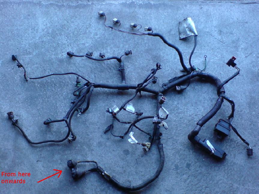

stripping the 306 on saterday and not totaly sure how much of the loom i need to take out and unsure of which fuel pump will be used

Hi mate, welcome to the forum. Im doing the same conversion in the next few weeks. You'll be using the standard 205 fuel pump. Loom wise you need everything from the two multiplugs to the engine (complete management loom). I think you should have 2 round multiplugs, a big one and a smaller one. You need to disconnect these from wherever they are in the 306 (there under the dash in the 205, probably around that area). It should look something like so:

First off, make sure you unlock the ecu. (Start the car up - with the code entered) and with the car running dissconnet the ecu).
Then them 2 round plugs. You only need the big one anyway. But you want to pull the loom back that runs along the cross member and upto the dash. Cut it before it goes in the car. Thats where you need to join the 205+306 looms. That should give you more than enough cable length to route the loom how you want it around the 205 engine bay. Double check what does what with a multimeter through the 19 pin round plug.
And yes. theres no need to take the loom off the engine unless your painting it. Just makes life harder for yourself when identifying what everything does first time round.

ecu is unlocked the only loom i took out today was the 1 in the above pic
need to take a look in the morning for the other loom,where will it run,up the same side as the fuel lines and stuff?
any 1 got a pic of this so i'am sure what am taking out, car gets crushed on monday.

:rolleyes: i was thinking the wires from the big round plug joined to the brown multi plugs under the 205 dash or am i totaly wrong?

You should end up with the two 205 brown multiplugs with say a meter of cable coming from them, you then join the wires coming from the multiplugs to the wires going into the 306 multiplugs that you chop off (as Alastair says)....
....I think anyway, look at my recent topic in the Aftermarket wiring section, there's a guide link in there for the Mi16, with similar principal in joining the two looms

had a look, is the loom that comes from the big round plug and into plastic trunking under the crossmember?
think i see what yous mean now,this gives you the extra lenght on the loom so you can get it through the bulk head and up to the brown multi plugs.
