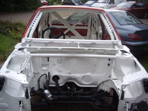

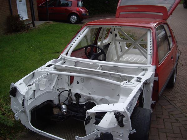

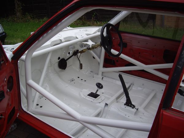

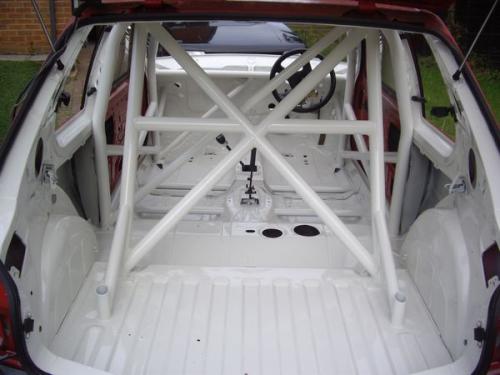

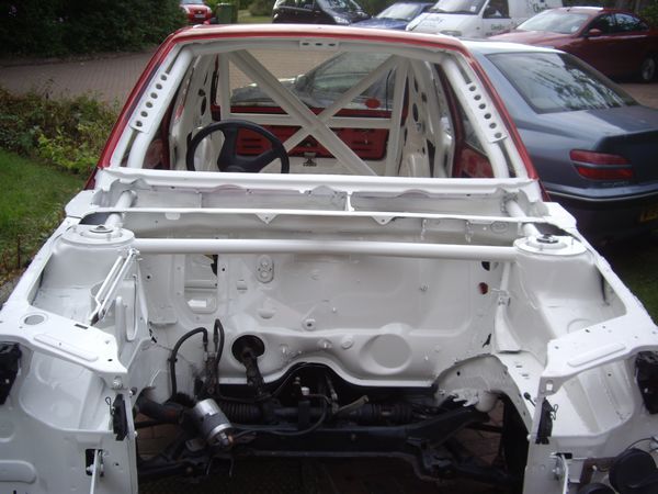

A long awaited update, few more bits done as you can see. Outside bodywork is next hopefully within a month or so. After which I will concentrate on getting the engine built up and into the shell.
Cage is by X Sport in case any one is interested, very good job too.

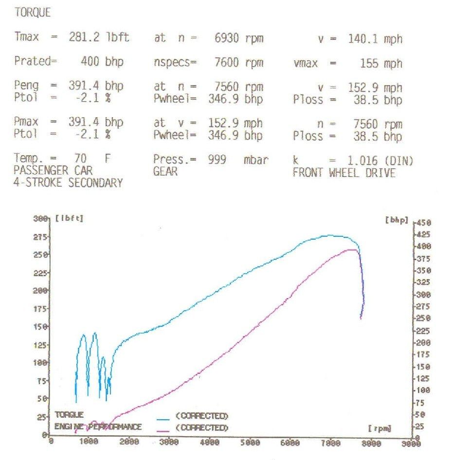

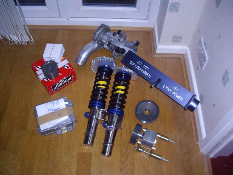

Also a small update: I've got a few more parts for the engine. Including what is pretty much Rich Walkers old set up including the larger throttle body and map which made very good power (dyno chart included in post). Over my christmas leave i'll be preparing the underside for some de-rusting and paint along with fitting the suspension and cleaning painting everything else.

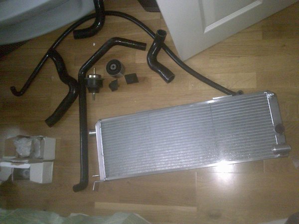

Finally started spending money on this again with the aim to have it complete when I return from Afghanistan in April 2010 or there abouts. Just ordered a collection of bits from BBM which includes:
Grp N Engine Kit
Grp A Rear Beam Kit
16v Hose kit
Shortened Alloy Rad
Next week I will be ordering my brakes, wishbones, pedal box and possibly rear shocks. This will see the vehicle suspension and brakes pretty much complete and ready to assemble when I return. Next port of call will be the engine and Body work :(

I've now ordered some more bits from Compbrake including:
RJ Wishbones,
Pedal Box,
330mm 4 Pot brake kit.
And finaly a Maxi Kit :)
