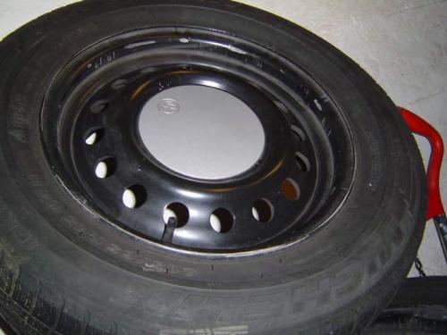

Gentrix 2 1 Cars Posted December 21, 2007 or try to get hold of some Citroen Steellook Alloys - they are 15" 4x108 and 18mm Offset + they only weigh about 4.8 Kilos. Get some nice rubber on them and paint them matching to your Car - maybe white, silver, gunmetal. andi Share this post Link to post Share on other sites

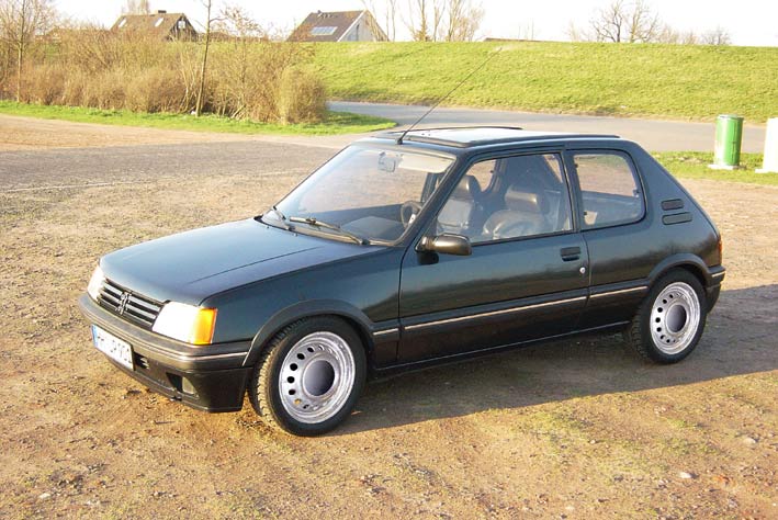

Gentrix 2 1 Cars Posted December 22, 2007 read here for the c5 Wheels http://forum.205gtidrivers.com/index.php?s...mp;#entry528878 http://forum.205gtidrivers.com/index.php?showtopic=52614 I made a photoshop pic to see how they could look Share this post Link to post Share on other sites

welshpug 1,663 Posted December 24, 2007 them citroen wheels look terrible imo lol they're VW steels not Citroen in that picture above. look for pics of sandy's 309 for pics of citroen steels, but they look just like any other PSA steel in reality, just a bit wider and lighter Share this post Link to post Share on other sites
hodgy 0 Posted December 24, 2007 they're VW steels not Citroen in that picture above. look for pics of sandy's 309 for pics of citroen steels, but they look just like any other PSA steel in reality, just a bit wider and lighter there VW golf MK2 steelies the escort SI,GTI,RS2000 (mk5 i think) wheels look good Share this post Link to post Share on other sites
Gentrix 2 1 Cars Posted December 24, 2007 (edited) there VW golf MK2 steelies the escort SI,GTI,RS2000 (mk5 i think) wheels look good No, they are Citroen wheels, but I tried the center cover from my Golf just for testfitting. If you fill the Badge, they would make a good cover as they fit perfectly on the wheelbolts and cover the hub. andi Edited December 24, 2007 by Gentrix Share this post Link to post Share on other sites
