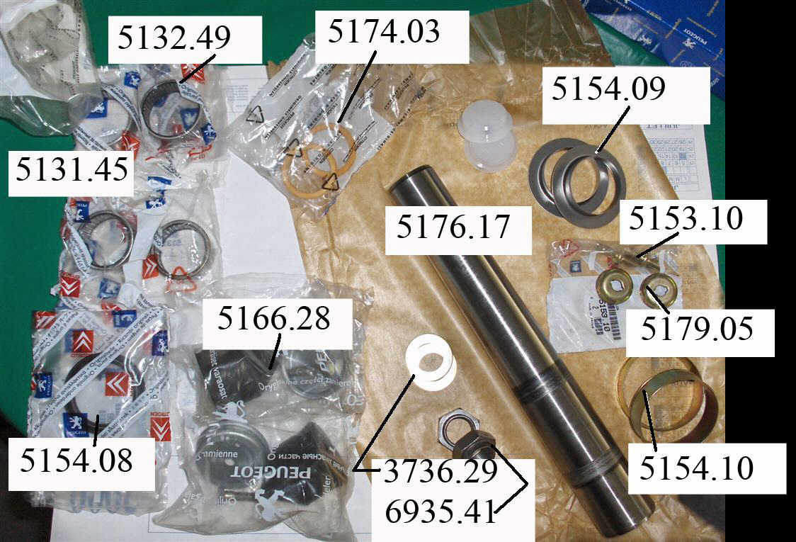

Parts to recon your axle will be dependent on how bad it is when you strip it & also what your local scrapyard charges for any bits you can use from a scrap 205 if you can find one that has a usable beam or centre tube. New parts from Peugeot for the bearings & seals is approx £65-70 but if you need the torsion bar studs add a bit extra on top. It'll be £80 max for all the small parts from peugeot but the radius arm shafts are £40+vat each from GSf.
You need to find use of a hydraulic press to get the old ones out & new ones pressed in.

I've attached a pictue with the numbers of the bits you need to order from Peugeot but you don't need everything from that picture & some of the bits aren't on there which you usually need. The torsion bars stud (5153 10), offset washer (5153 12) & torx screw for the offset washer (5153 11).
