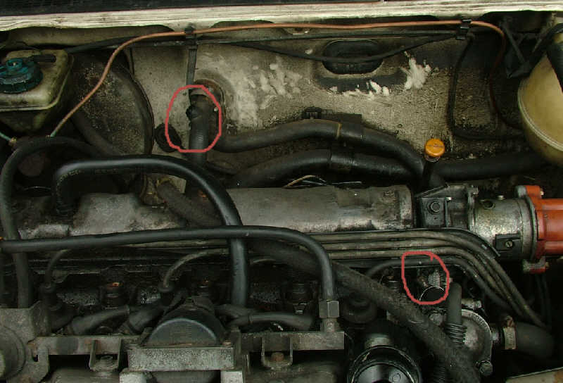

pug_ham 245 3 Cars Posted November 25, 2007 (edited) Changing the thermostat is easy; Drain cooling system. Remove radiator top hose to thermostat housing. Remove two 13mm bolts & pull cap off, exposing the thermostat. You'll need two new seals for the thermostat after you've removed it, they've probably been on since new so will be well past re-using. Bleeding the system is through the two bleed points, one on the hose to the heater matrix near the bulkhead & the other on the thermostat housing. Graham. Edited November 25, 2007 by pugtorque to add picture Share this post Link to post Share on other sites

large 33 Posted November 25, 2007 To blead the system there is a small screw in the top of the pipe by the master cylinder as for the stat the big pipe you had hold of befor (that sounds sooo wrong) where that fits onto the engine you have a dome shaped thing held on with 2 bolts, just remove that and the black thind is the stat. Share this post Link to post Share on other sites
