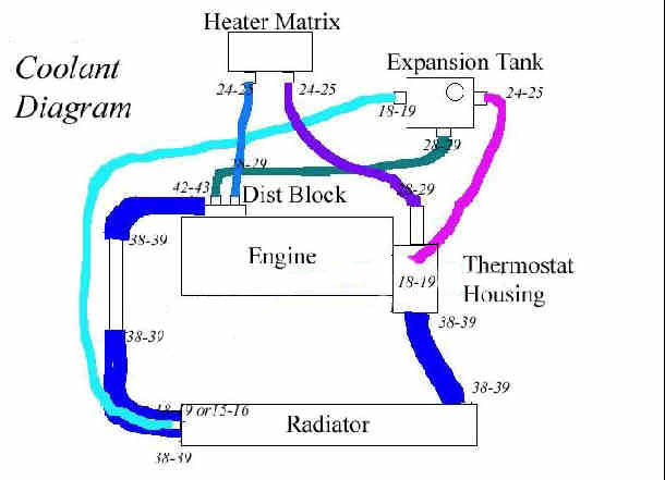

Make sure you can get the screws out to remove the slam panel before trying the jubillees!
any old hose clips. i take it i will need specific sizes?
See attached drawing for sizes of jubilee clip you need in mm's.
