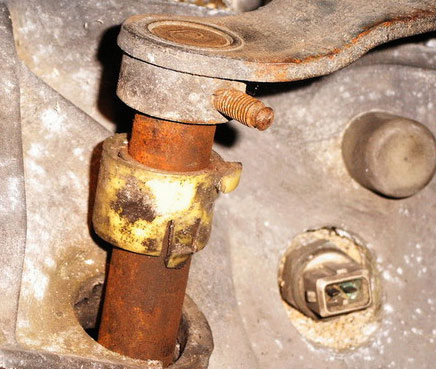

Also check that the notch on the yellow plastic bearing is in the correct position. It had snapped off on mine a few weeks ago and I couldn't get into gear. :lol:
(pic courtesy of welshpug B))

As the conversion from BE1 to BE3 seems to have been "agricultural" I guess there's a chance that the release bearing (the only difference between the two clutches) has been adapted to fit, too- YOURS SHOULD BE LIKE THE DIRTY ONE ON THE LEFT
Only way to find this out is to drop the 'box - so I'd try and source a pedal and cable first! Be warned, most factors get the part wrong when you order! Maybe someone here has a part number they can post for you????
