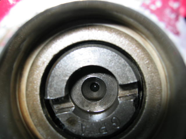

philfingers 5 Posted November 1, 2007 I;ve got a new car, supposedly fitted with a PTS GpA cam, does anyone know the specs of this. It has GP A stamped on the end of it, would this be correct? Thanks, Phil Share this post Link to post Share on other sites

pug_ham 245 3 Cars Posted November 1, 2007 There used to be three different group A cams, 1.9 'Peformance' (7060), max torque (7048) & max "top end" (7040). Oddly the max torque was the cheapest. Graham. Share this post Link to post Share on other sites

philfingers 5 Posted November 2, 2007 Not sure what springs are with it, even if it's got large valves. The head has LAD stamped on it and the guy i bought it off said the ID of the head indicated it was built for Richard Burns when he did the challenge. However no proof. Does this like a genuine PTS cam then? Any way of telling which one it is, are they colour coded for instance? Phil Share this post Link to post Share on other sites
pug_ham 245 3 Cars Posted November 2, 2007 The head has LAD stamped on it and the guy i bought it off said the ID of the head indicated it was built for Richard Burns when he did the challenge. However no proof. Maybe its one of those magical 160bhp engine french cam's that when measured is exactly the same as the standard cam. Does this like a genuine PTS cam then? Any way of telling which one it is, are they colour coded for instance?Phil I'll try to have a look through the 205 1.9 group A homologation papers later & see if it has any spec for this cam or any others, I'm skeptical as the other PTS cams have the number stamped on the end (7048, 7040) so I'd have expected this to have the same & have 7060 stamped on instead of grpA. Graham. Share this post Link to post Share on other sites
