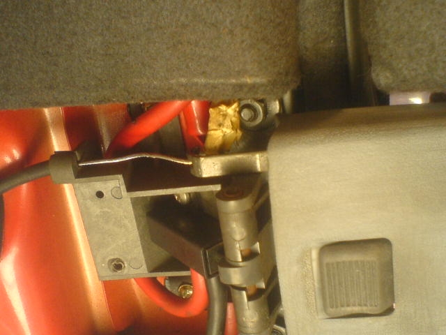

My sunroof isn't openning these days... Although the vacuum mechanism is working perfectly (pressurizes, depressurizes) the locking cable isn't attached to anything thus prohibiting me from the warmth of the sun!!! Where does the cable hook on to? Is it the roof's handle or are there any other side mechanisms operating it???
Would very much appreciate pictures on the working parts sice dealers here have absolutely no idea what's wrong and don't have the parts available to see (they have to order them from the peugeot dealer at buyer's expense!!!)

Hi, hope this helps. Usual problem is that the soldered nipple of the release cable pulls through. I drilled through a small screw, passed the cable through it and clamped it together. Had to open the prongs on the mechanism a bit to fit it, but has worked fine for the last 3 years!

Thank you Steve!!!! That's all I needed to see!!!
How is the metal thing where the cable goes held on the handle?
