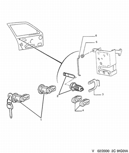

Edp 67 3 Cars Posted October 25, 2007 The lock is held in place with a metal fork (3) which slides in and holds the lock in place from the inside. You will also have to remove the metal rod which connects to the main lock. Once you slid the fork out the lock will pull out. Share this post Link to post Share on other sites
