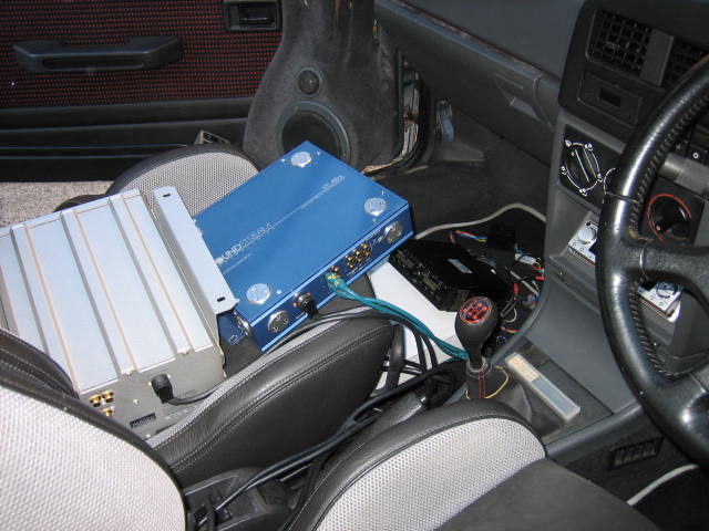

I've simply moved mine out of the way a little, to give me some room. There was just enough slack on the cable for me to mount it underneath the glovebox without having to disconnect it.
Would that be an option?

Thanks for reply, will try getting more slack today from cutting off cable sleeve in car end, hopefully this enables me to remove latch then unhook cable.
Looks like my 1990 309 has different latch to 205
