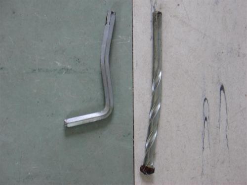

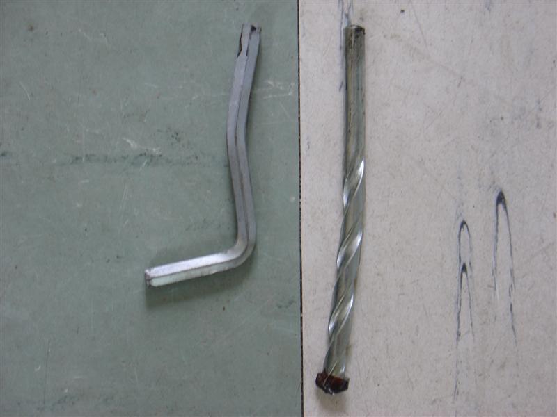

skeggyrik 3 Posted October 6, 2007 (edited) What have you lot used in the past to lock the crank pulley while you undo the crank pulley bolt and spacer? I've soaked it in WD40 but it won't shift. I've just bent a drill bit and an old allen key trying to get it free. It can't be too long othwewise i can't get the socket over bolt. Ideas? Oh and so much for halford pro tools, i snapped the 55Torx bit on the second head bolt, so i'm off down there now to get a replacement (lifetime garantee so should be free). Edited October 6, 2007 by skeggyrik Share this post Link to post Share on other sites

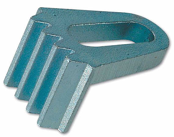

pug_ham 244 3 Cars Posted October 7, 2007 If you intend to keep a 205 for any length of time then its well worth spending about £10 on a proper flywheel locking tool from franklin or Snap on. Locks into the flywheel & stops the engine turning no matter how much torque you need to get the flywheel bolt undone. It takes very little torque to break the webbing off on the engine plate. Graham. Share this post Link to post Share on other sites

skeggyrik 3 Posted October 8, 2007 It takes very little torque to break the webbing off on the engine plate. I found this out. Engine is out of the car, flywheel is off and it's on an engine stand, so I persisted with locking the pulley, I bought a 10mm bolt with a long plane section and cut it down and it fit perfectly locking the bottom pulley (much better than the allen key/drill bit pictured above). Before I went back to it, I checked the forum but it was down "being updated" So I went ahead and I managed to snap the webbing off the block, much to my disgust. The salt in the wound was checking the forum responses to find the warnings about that very scenario. So I got no further, it's still on there and I've snapped the lug off the block. God knows where it shot off to. Don't know what to do about that…... I need an air gun and compressor to get it undone, so I might get mobile mechanic to come by and do it. I'm not about to invest in all that gear. As for the Torx bit Halfords were no issue when it came to replacing the snapped bit in line with the lifetime guarantee, so that was good. I need to get me a meatier torx bit though, don't want to snap another one, nearly gave myself a black eye the first time. Not happy all round. Share this post Link to post Share on other sites

pug_ham 244 3 Cars Posted October 8, 2007 What happens if like me you have also done this? Does the block need replacing or can you still use it ? No, the block doesn't need replacing. The part of the block with the webbing on is just an end plate, fitted to most XU engines so you should be able to find one in a scrapyard if you want to replace it imo. i need to remove this bolt so i can fit on the Piper Cam Timing disc so i can check the vernier pulley settings anyone know of an easier way to do this while the engine is still in the car?! another thing, what webbing on the block, cant think which bit u mean, any pics?! With the engine in the car its an easy job, either buy a proper flywheel locking tool like I posted a picture of above or it can be done with a decent flat bladed screwdriver at a struggle. The webbing in the block is in the picture attached to this post. The bolt through the pulley is located in it but its usually hidden by the belt covers. Graham. Share this post Link to post Share on other sites
