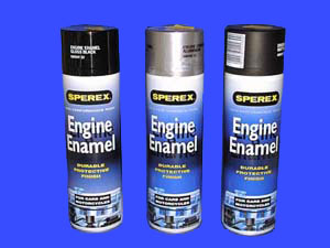

I think I missed something..
What sort of paint did you use for engine block, inlet manifold and gearbox casing? Primer? Air gun or spray can?
Edp
Ed, prepared to be swamped with PM's from people asking you to do their conversion too!!! Looks better than factory mate, absolute top job! When I see you in person, just a couple of suggestions I normally keep under my hat that you might like to implement! Really really is A1 work!
Maxi
Cheers Maxi, that means a lot. We'll have to hook up now as I'm intrigued on these suggestions :D
On the block I used Gloss black Sperex engine enamel and on the head, sump and inlet manifold the same stuff but in Matt silver. Really good stuff and dries real quick.
The gearbox casing was sand blasted and powder coated as it was smothered in grease and would've taken a month of evenings to get it looking like that! I had a right touch with that too, the guy got confused with my order as I had loads of bits and the gearbox ended up only costing a tenner <_<
