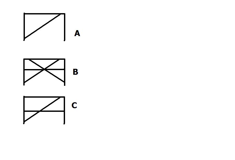

Hi, i've got 7 feet of 38mm cds which i bought weld in for harness bars . I'm looking for some advice on the correct fitment into the roll cage . its an SD cage which has allready been modified , so altering further isn't an issue . i would just like to fit them so they are safe .
i've done a quick drawing:
A = what i have at the moment
B = what i've seen. is this how it should be done?
C = is this ok? its all i have enough steel for
or alternatively i can do the x brace in cds and i could do the horizontal for the harnesses in some other more readily avaliable steel?
can it be fixed to the back of the frame or does it have to profiled into the cage as with the rest of it?
cheers, Al

'C' will be safe enough, i've seen alot of people with both 'B' and 'C'. I've got 'A' and the harnesses fix into eyelit bolts in the floor. Personally i'd profile it, it looks better, neater and more professional and I'd guess it's stonger too. it's not difficult to do, I added some door bars (with help) and it only took about 30 minutes to profile them both in and weld them nicely.

Ive got B on my challenge spec SD cage and ive seen this style most commonly. But Ive also seen a few of C but profiled to the cage rather than just welded onto the face.
I guess it depends what you are intending to use the cage for - If you have to satsify a scrutineer Id do the best job I could. If its just for track days then maybe you can lower expectations a little but at teh end of the day a cage is a safety item therefore personally I wouldnts crimp on anything

I am having the same done to my rollcentre cage. I am going for B and all profiled so that it looks "factory". I was advised this as all produced cages that have harness bars are in this configuration (please don't reply with ones that aren't as I am just stating what I was told). Also in a roll over situation, more strength is added to this section of the cage with the double cross, so there is less chance of the harness mounting being effected.

thats how CC did mine

Mine's a "C". Never had any problems at scrutineering etc, but it is done properly with shaped tubes etc.

thanks chaps , i think c looks best and is more symmetrical. having a look again i see the rear diagonal doesnt line up with the two vertical diagonals. this would make C look odd . i'm just going to have to get ripped off again buying another metre of 38mm tube off ebay :) to do B.
