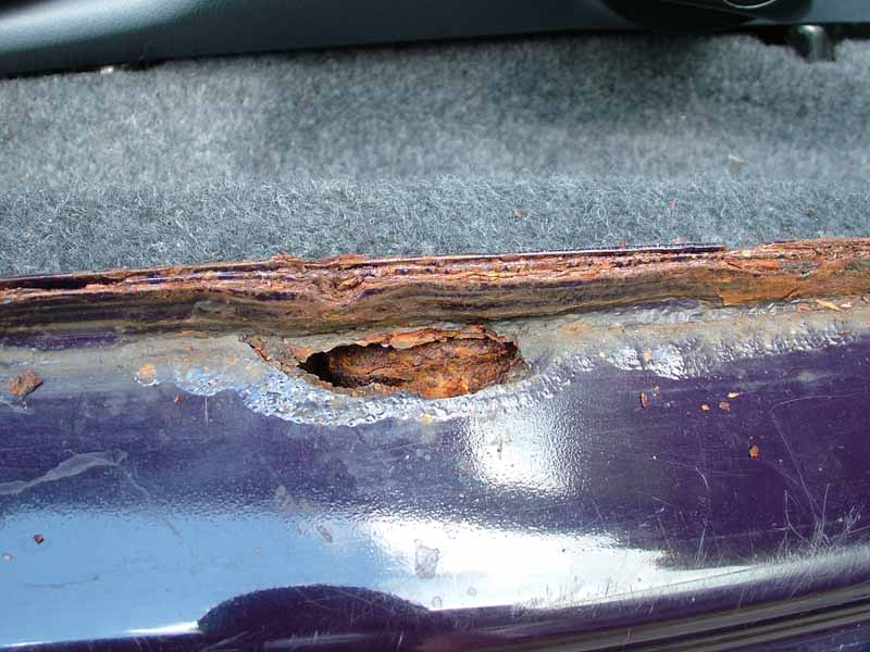

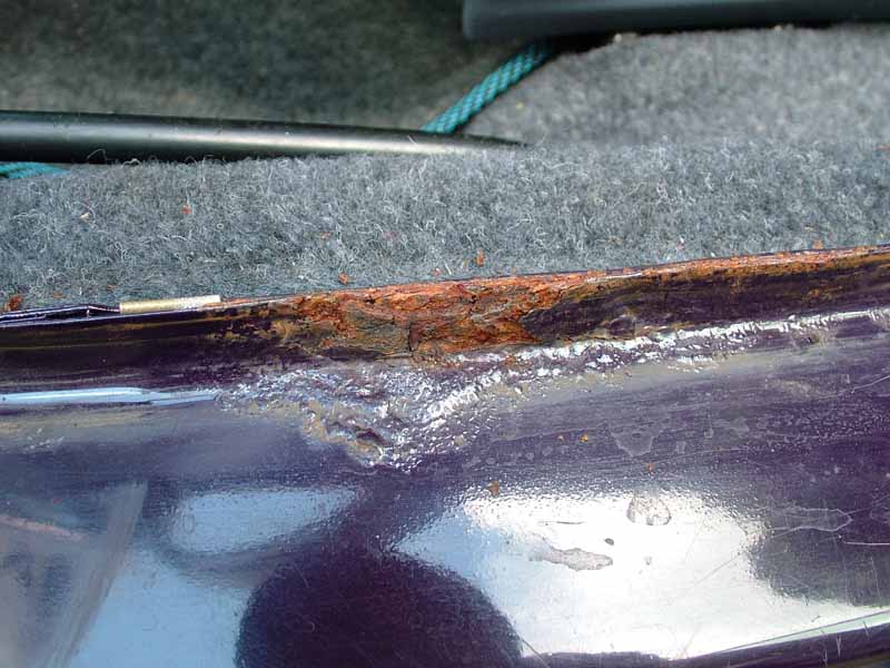

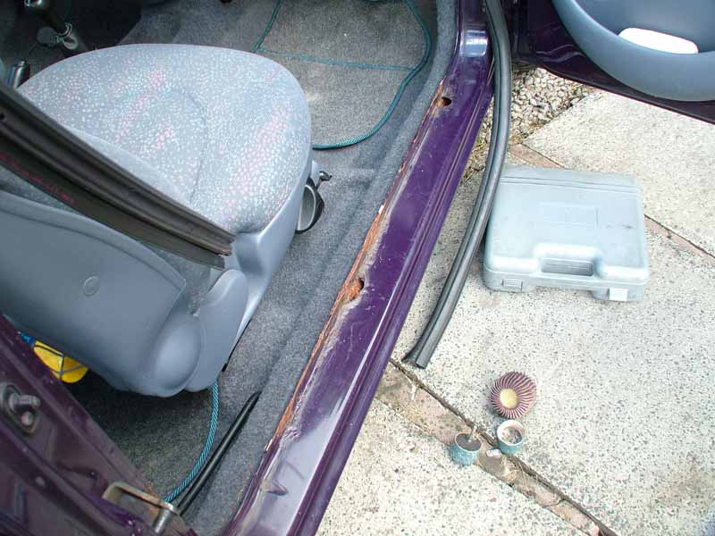

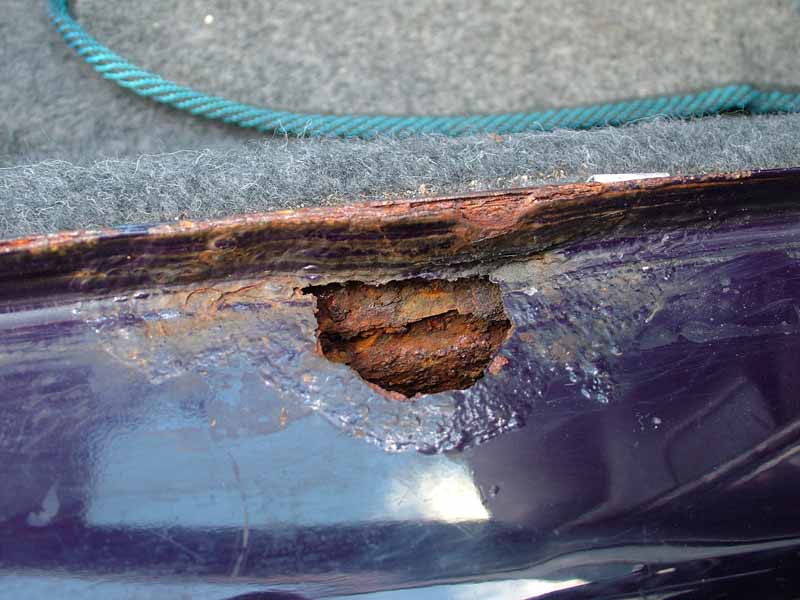

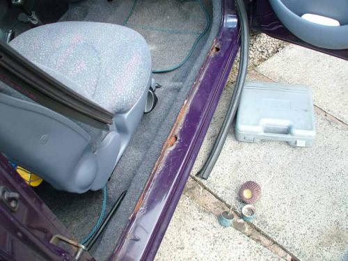

Now, before I get shot in the face, it's not a 205 gti. It's a friends Ford KA. He found some rust on the sill, under the door seal. Today we planned to sand it all down, get rid of the rust and then use some mesh and filler.
When he took the seal back, he found a shedload of rust, running right along the sill. So basically, i'll post up some pictures and if someone could hand out there expert advise on it, we'd be very grateful. He's thinking of selling the car, so the most cost effective way is imperative. So, if anyones got some advise on how to go about fixing it and de rotting, or how much a body shop would cost to fix it up, we'd be very gratefull. Thanks again

that ideally needs grinding back and plates welding on to it really. just bodging it up with filler and mesh is going to look awful, not to mention it will be dangerous. the firdt thing a potential buyer is going to do if they see that is to give it poke. it wouldnt take much to go through a bodge.
gti-si
Yeah I thought that myself, people do tend to check the sills for rust spots etc. Welding some plate in there seems a good idea. What about the inside of the sill? It seems superficial on the inside, and theres some light surface rust on the inside bottom. Grind the rust back then check out the side wall? If we do all that, what kind of weld does it need? I don't have a clue about stuff like that...Would it need seem welding or just tack welding then sealing?
He is completly skint atm, and has other commitments money wise, but, it need's sorting soon before it gets alot worse. How much could two body work numpties do? Just a case of aking as little work as possible for the bodywork man.

Mikey S
Haha, I was thinking as I posted it "I hope Steve doesn't have a heart condition"
just concentrate your efforts on the 2 holes and get them welded up. if you take a grinder to the surface rust its bound to create a hole and leave you with even more work than when you first started.
you need to start by grinding all the way round the 2 holes to expose good fresh metal that your bodywork man can weld too. if you can do as much preparation work as poss you may find that a local garage would only charge 40 or so quid to weld it up for you. once its welded get it ground down as flat as possible and shape it with some filler. mask it up and spray with some underseal.

You have a couple of options really depending how much you want to spend and what finish your after.
Firstly have you pulled the carpet up to check the inner sill? Youll have to clean back the surface rust to make sure its solid metal, otherwise the welder will blow holes through it, and if not, the MOT man will with his screwdriver :wub:
Assuming that the inner sill is o.k, then you can either make a repair section, butt weld the new metal in and blow it over with a rattle can - what colour is the car by the way? Metallic? . It'd pass an MOT, look hardly noticeable and personally id charge around £150.
The proper way is a new outer sill, id guess most will charge around £200-250 plus parts. But that would be painted in a booth with a factory finish.
Or, it pains me to say it - you can plate over the hole, youll need to seam weld it - weld an inch leave an inch - and thatll get you through mot, its the messiest but cheapest and easiest way.

Mikey S
im going to argue with you on this one. it needs to be continously welded to pass an mot. if i looked at an repair patch and i could see it was welded like you suggest i would fail it.

Paintguy
My first thoughts! The one we did recently wasn't as bad as that on the outer sills, but had up to an inch gap between the floor and inner sill! :lol: Check that out before you go any further.
I'd agree with matt - 'best' way would be to replace the whole outer sill, but cutting right back to good metal and welding in a patch might be more realistic.
Has it gone around the petrol cap and rear wiper arm yet? If not, it will do soon :wub:

and what state is the inner sill going to be in?! doesn't look too good from the photos

I think he breifly checked the inner sills today and said it didn't look too bed. I think the footwell will be on it's way soonn though as theres been a puddle in there. I don't get how Ford have done f*** all about the rust problem, they've had atleast half a century!
Pugger would that be a straight MOT fail? What about with the sills botched?

if the patches are not continously welded i would fail it tbh. you can tell instantly whether a sill has been botched, if he has any doubts that it has, he will use the 'corrosion assesment tool' on it. a botched repair wont stand up to a few pokes with that.
