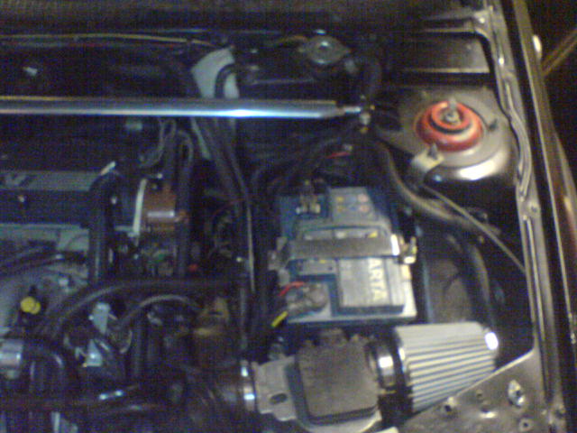

M@tt
i relocated mine when i fitted my mi16 engine
i extended the plug wiring throught the trunking that goes round the bottom of the radiator. The relay box also fits in nice and snuggly as well (not the one in the pic i used a smaller one)

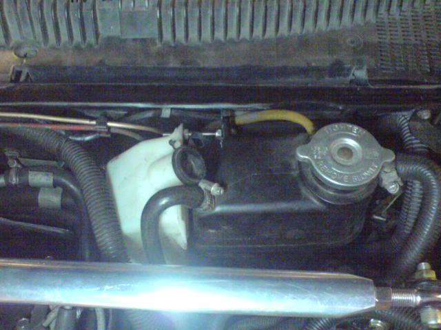

5150maxie
heres my latest mod.its a 309 gti rear washer bottle.all i did was put a longer bolt on the header tank and lengthened the wiring.
