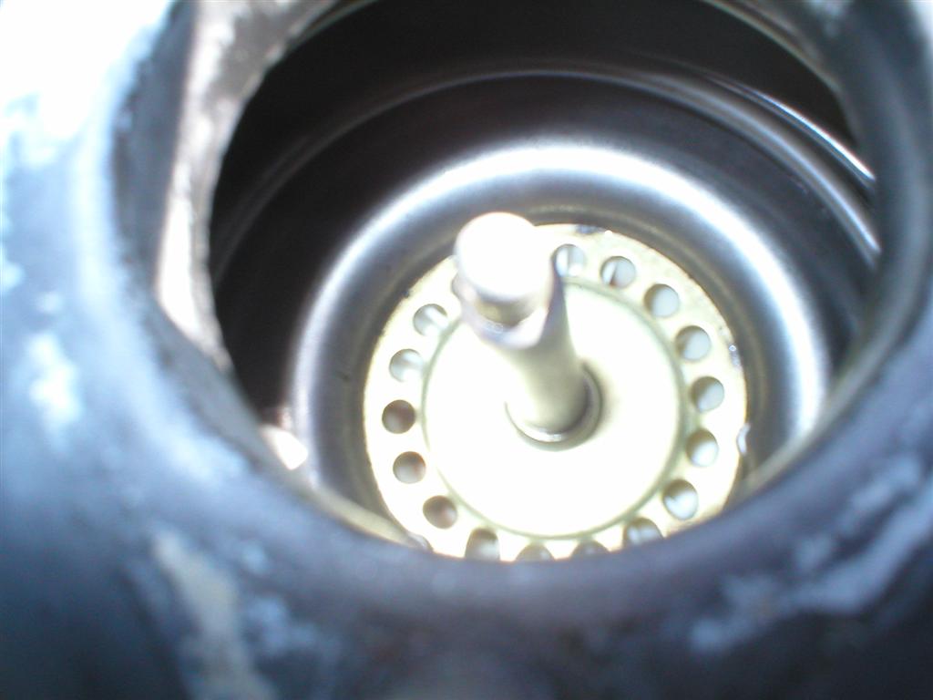

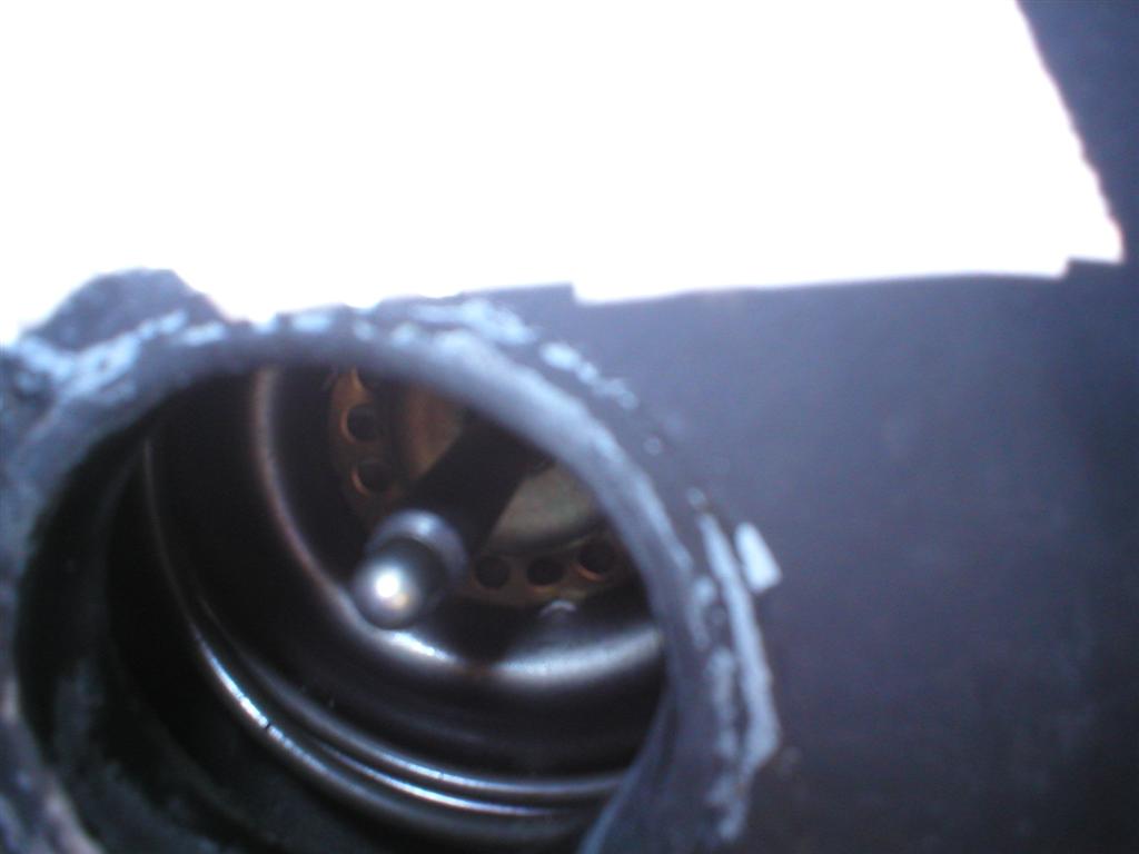

futura 3 Posted August 4, 2007 I have just taken the MC out and here is what I find: No locking nut, just a pretty loose rod (normal?) that I can spin around itself but it doesn't seem to be adjusting. Any ideas how to adjust this bloody rod, my pedal has dead travel at the start, which means when I first press it I have to bring the rod in contact with the MC and only then it starts braking, very annoying! Share this post Link to post Share on other sites
Normski 1 Posted August 4, 2007 I've just done this not so long ago. Hold the brake pedal down with something, so the rod is moved out. You can then grip it with mole grips and turn the nut. Release the pedal and measure the distance between the servo flange and the nut. As std it should be between 22.2mm and 22.4mm. I set mine to 22.2mm to get the pedal 'high'. Share this post Link to post Share on other sites
futura 3 Posted August 4, 2007 Thanks Normski, but I still can't see where the nut is? Share this post Link to post Share on other sites
Normski 1 Posted August 6, 2007 I can't quite see on your pics, but on mine the tip of the rod has a hex around it. I had to grip the rod a cm or 2 below this to stop the rod from rotating so the nut could be adjusted. Share this post Link to post Share on other sites
