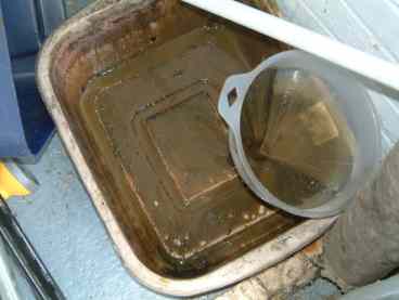

Removed the inlet manifold and put some instant gasket around it (new gasket will be fitted later), jobs a good'em, no more smoke! Changed the oil, which looked like ditch water, now the oil is nice and clean! I also did a compression test, and they all read around the 14 on the tester which isnt too bad, I think ( need to do some search to check on this).

The colour of the oil I drained out of the pug this afternoon, before I started the car is was a nice clean gold colour!
The black bits, are from what was left in the bowl from the time before.....
