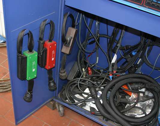

Emmy Seize 8 Posted December 4, 2007 (edited) So, live monitoring even the L Jetronic sensors shouldn´t be a problem if you follow the "piggy back" route. This was how the old Peugeot tester did things even on Motronic cars. To avoid a lot of wiring and soldering connectors, you should try to find one of the old interfaces that plug between loom and ECU for testing purposes. This would give you a proper break out box without changing anything on the car itself. I can look up the part numbers and take some detailed photos when I´m in the workshop. The green or the red one, for example: Edited December 4, 2007 by Emmy Seize Share this post Link to post Share on other sites

jackherer 543 Posted December 4, 2007 ebay: 140184491890 wont send to the UK though... (I suspect that particular one is for a 405 8v but he says he has others) Share this post Link to post Share on other sites
