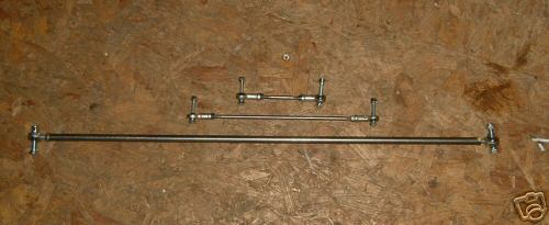

has any one got any pictures of them fitted with mods to linkages?

They're easy enough to fit. What I did was, I ground the back of the little balls off flush with the arms, and then clamped the balls with a pair of mole grips, and pulled them out of the arms. That left behind a hole through which the bolts of the rose joints fit. I spaced the rose joints away from the arms by using some washers in order to get maximum movement from the joints and used some "allen key head" bolts and nyloc nuts. If I remember correctly it was 4 x M6 and 2 x M8

I hope that these are of some help to you. I made the linkage rods myself, and the difference its made to the car is amazing. I fitted one of the original "GE" quickshifts when I built the car about seven years ago, and I thought that was good, but coupled with this mod, the gearchange is bomb proof and will never pop off again. Deffinately one of the best things I've done to the car.........you won't regret it.

thanks :wacko: there just what i was looking for.my selector arm on the gear box for the smallest rod is different to yours i cant grind the ball end of because it on the arm :)is yours a be1 box?

mine has the ball cut off then a short section of M5 rod welded on to the end.
If the box is off the car then cut the ball off then drill and tap a thread and wind in a stud, be better than the welded option my box has cause you can replace the stuf if it snaps then, I'd be stuff it it broke currently :s
