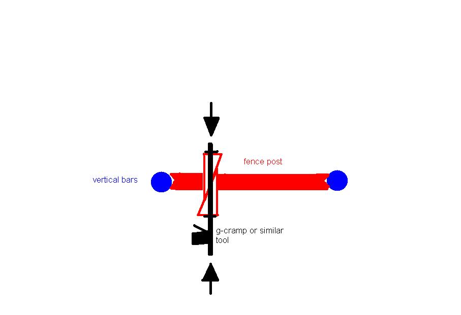

Pugnut 9 1 Cars Posted June 10, 2007 ok, so now i'm sober i've done a quick drawing of how i did both my front bars and b pillar bars . this is pushing out obviously . pushing inwards the scissor jack sounds a good idea. just a couple of wedges nailed onto an old fence post . i needed to cut notches out of the fence post to positively locate it round the vertical bars on the cage. cheers, Al Share this post Link to post Share on other sites
