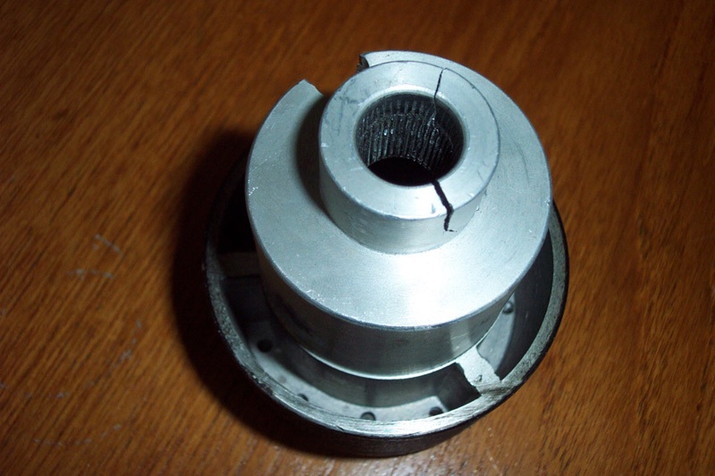

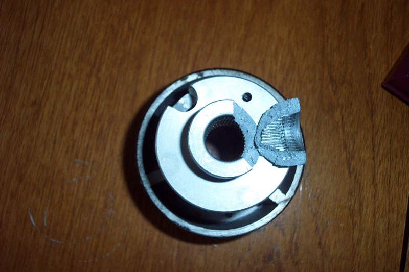

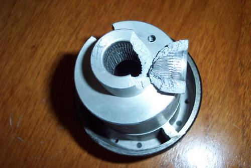

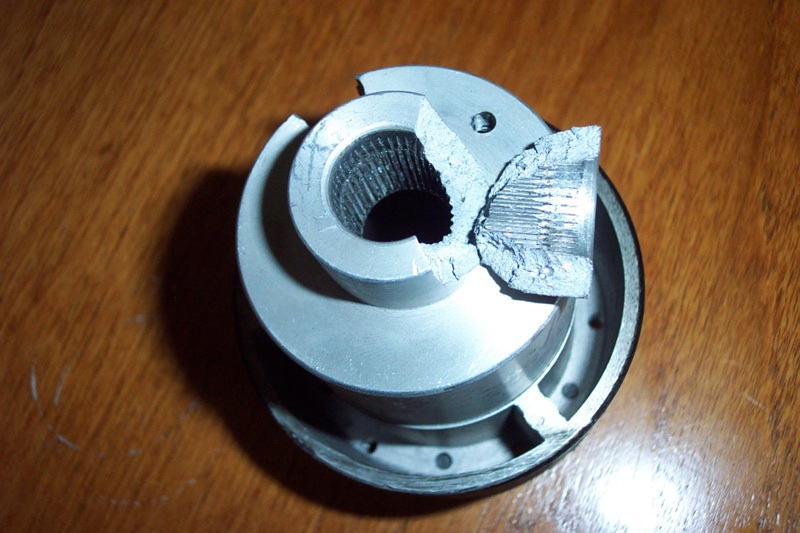

jackherer 543 Posted May 30, 2007 I have been trying to solve a very slight bit of play in the steering of my friends 205 for a long time now, I've changed the column and rack and tried loads of other things such as tightening loose subframe bolts in an attempt to cure it. Eventually I found the problem, it was the aftermarket steering wheel boss, once it got very bad it became obvious and once I took it off the column it fell apart totally. I'm glad I found it before it failed totally, it could have been a very scary failure! I don't know who made this boss but I wouldn't want another one the same... Share this post Link to post Share on other sites
DaveK 0 Posted May 30, 2007 wow that would have been a nasty smash indeed. There are parts out there that are worse than the french's? Share this post Link to post Share on other sites
GLPoomobile 958 Posted May 30, 2007 having experienced a steering wheel coming off I'm my hands half way around a large roundabout I can confirm it is a scary situation indeed! reckon he's had a lucky escape. Share this post Link to post Share on other sites
