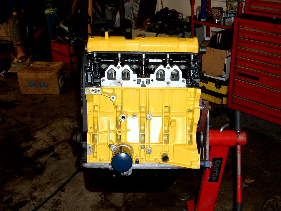

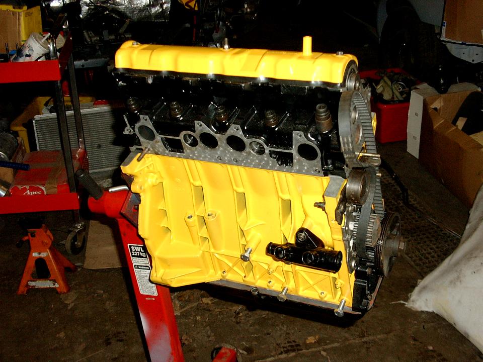

205turbo 32 2 Cars Posted May 28, 2007 (edited) Well my TT needs to be finshed for pugfest so i collected the engine today from Mike with Alastair help (cheers bud) and fitted the new oil pump Anthony bought up on saturday, I also converted the 306 dturbo box and fitted the Atb diff, hopfuly i should have it in by this weekend Edited May 28, 2007 by 205turbo Share this post Link to post Share on other sites

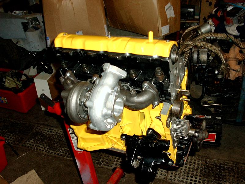

205turbo 32 2 Cars Posted May 29, 2007 I've got a GT28Rs to go on it Share this post Link to post Share on other sites

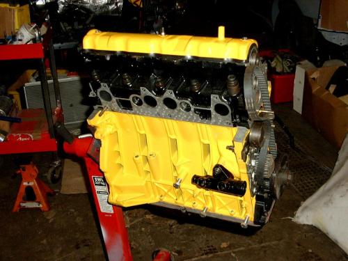

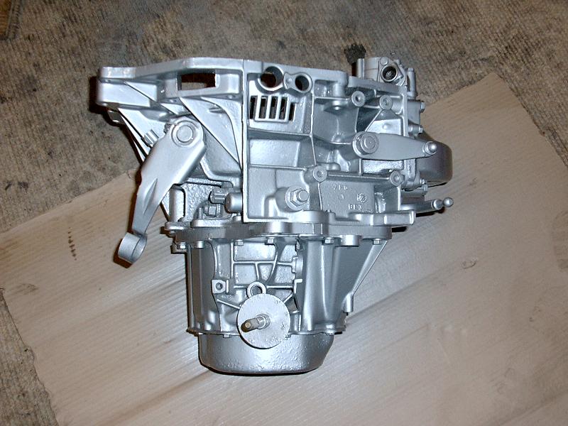

205turbo 32 2 Cars Posted May 29, 2007 (edited) had a thought about the silver gearbox not going with the engine so i painted it tonight i'm also having a new rocker cover done which has a zetec escort cap welded in to it, as i hate the plastic type Edited May 29, 2007 by 205turbo Share this post Link to post Share on other sites

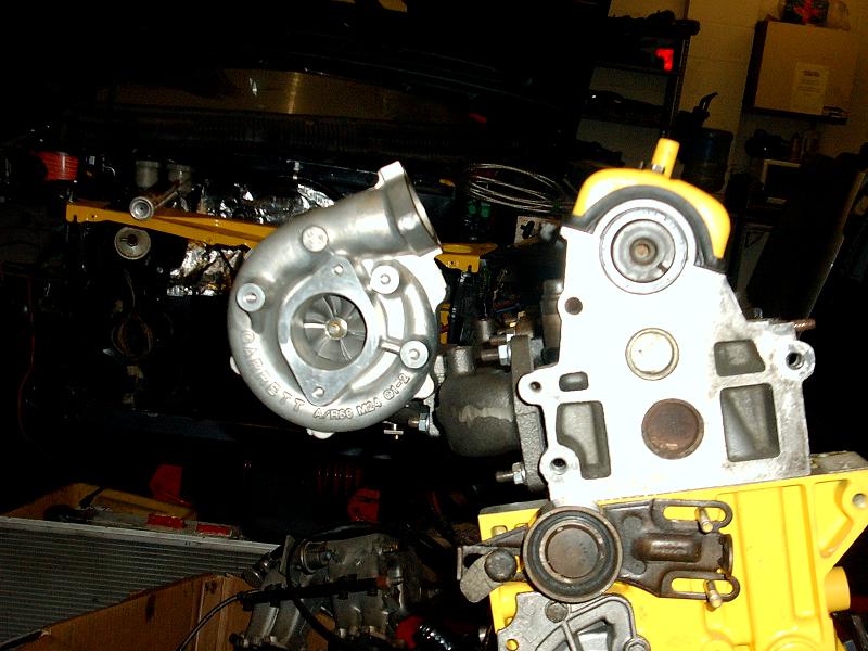

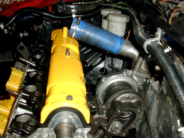

205turbo 32 2 Cars Posted May 30, 2007 i've had to alter the turbo housing to get the output in the right direction Share this post Link to post Share on other sites

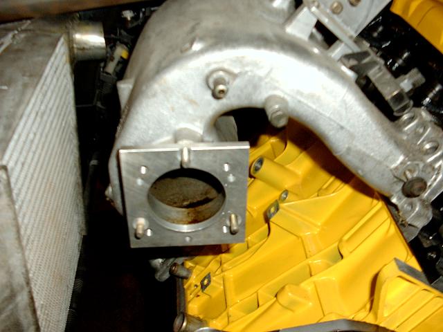

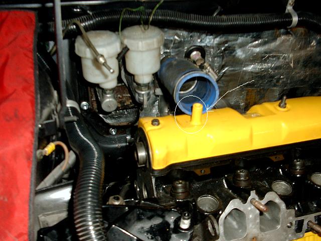

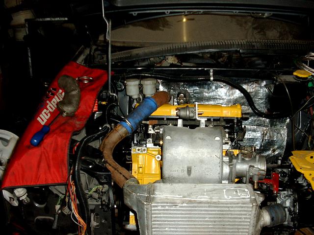

205turbo 32 2 Cars Posted May 30, 2007 (edited) decided it would be wise to fit the engine and box to see if there was enough room, all i can say is thank god i have a peddle box, There 10mm space on the housing before it hits the bulkhead heat protection going to have to cut the breather off on my new rocker cover and move it out of the way this is plate is used to mount the 72mm Throttle body Edited May 30, 2007 by 205turbo Share this post Link to post Share on other sites

tom_m 0 Posted May 31, 2007 205turbo said: I've got a GT28Rs to go on it 205turbo said: i've had to alter the turbo housing to get the output in the right direction thats not a GT28RS, thats a GT2560R, formerly known as the GT28R. and you're right, there is no way that would have fitted without the peddle box, believe me, I've been there Share this post Link to post Share on other sites
