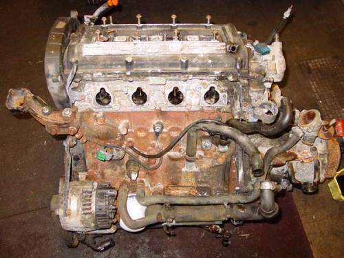

There's a few different mounts for the Alt, The one shown has power steering but should give you a idea of what's what along with a couple of oil pipes
The oil Filter thread can be bought from Pug or most automotive hose/fitting companies.

Is the oil pipe running along the bottom then up, the oil filler pipe? Or is it the middle of the block one?

I have seen a diagram from Petert about oil pipe layout but its not very clear. Has anybody got a clearer one, Will I be able to use the oil pipes from the 1.9 or will I need new ones so they reach the right places?
Depends on what inlet manifold your using, as the pipes go more with that than the block, I'd stick with the 1.9 inlet myself
huzzer
I will be using the 1.9 inlet. As far as i can see, this is how it goes. (you may have to use your imagiation :P )
Using 1.9 oil pipes...
Starting from the bottom left next to oil filter...
Oil filler pipe (I think I need to cut off and block up the breather that goes up to cam cover)
Next one along to the right connects to breather on cam cover.
Furthest one to the right connects to the breather on oil filler cap.
Sound right??
