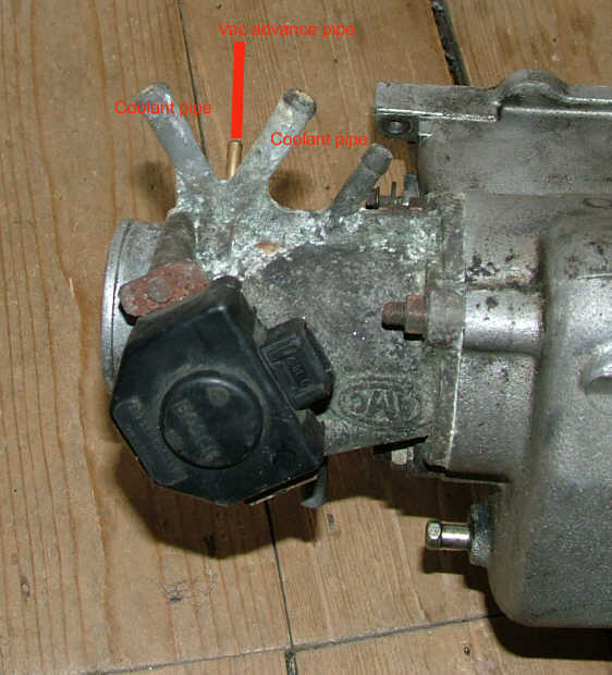

pug_ham 245 3 Cars Posted May 30, 2007 What connects these two?Nothing, the left one is a coolant pipe that goes between there & the coolant temp sensor housing & the other is the SAD which connects to a pipe from either the bottom of the inlet manifold or the pipe between the AFM & TB. What connects into these? I don't think they are all used but one of the connectors will be for the ecu power (thick brown wire possibly or the yellow ones in this picture)Whats this for? Throttle switch on throttle body imo. (see this picture) What does this connect to?Not sure, where do the wires run to?What should be at the other end of this pipe?The SAD (see your first picture)What goes at the other end of this pipe?The coolant temp sensor housing. Your replacement engine looks to be a late phase 2 without this housing so you need a different hose that fits directly to the side of the thermostat housing in your first picture.What goes on these three?The middle two are all you need, one goes pipe goes to here from the thermostat housing & the other one goes to the expansion tank iirc. (see this picture). The smaller one on the left isn't used.What connects to these?The only connections you need to find there are the spade connector & nut above it on the solenoid. The wire to the nut comes from the battery distribution block here. The two at the back of the starter are for a plate which fits to the starter & then to the block & thats best left off imo.Oil pressure switch?Oil pressure sender unit, switch is next to it.Where did these come from?Not sure, is it fixed to the bracket or has the loom just fallen down there? If its fallen down then some of them could go to the coil in this picture imo. Share this post Link to post Share on other sites

Grim.Badger 15 Posted May 30, 2007 The middle two are all you need, one goes pipe goes to here from the thermostat housing & the other one goes to the expansion tank iirc. (see this picture). Three Pipes The left one is Vac advance and the other two are coolant hoses that should connect to the Thermo housing and something else iirc. Although I could be wrong, I do have problems with my coolant atm I think you need to get one of us down to help mate as it looks a big mess. Share this post Link to post Share on other sites
pug_ham 245 3 Cars Posted May 30, 2007 The left one is Vac advance and the other two are coolant hoses that should connect to the Thermo housing and something else iirc. Although I could be wrong, I do have problems with my coolant atm The vac advance pipe can't be seen in that photo. (see attached picture) The vac advance pipe sits between the two pipes at approx 90' apart but the one on the left is unused as I stated in my previous reply. The two pipes that fit to the TB, one comes from the expansion tank & one from the thermostat housing. Graham. Share this post Link to post Share on other sites

Grim.Badger 15 Posted June 1, 2007 The vac advance pipe can't be seen in that photo. (see attached picture) The vac advance pipe sits between the two pipes at approx 90' apart but the one on the left is unused as I stated in my previous reply. The two pipes that fit to the TB, one comes from the expansion tank & one from the thermostat housing. Graham. Sorry Graham I was just sure that my TB only has three pipes and so the third smaller one must have been the vac advance. Maybe I need to check my TB Share this post Link to post Share on other sites
pug_ham 245 3 Cars Posted June 4, 2007 Sorry Graham I was just sure that my TB only has three pipes and so the third smaller one must have been the vac advance.Maybe I need to check my TB There are different tb's & some of them have only two coolant & the vac advance pipe underneath, I have one of these downstairs somewhere. Graham. Share this post Link to post Share on other sites
