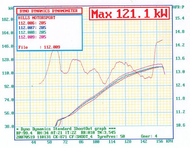

When I ran in my new engine on the dyno, I thought I'd given it a conservative 25 degrees of maximum advance at full load, from 3000 to 7500 to produce 123kW at the wheels. It has 11.8:1 CR, runs on 100 ron fuel and has CDI ignition. Yesterday I did some very brief experimenting with ignition advance. Well respected tuners had suggested I should be running 30 degrees. I didn't think it would need that much.
So I did a few power runs. For the first run (red) I reset the full load points all to 28 degrees. This yeilded approx 117kW. Down nearly 6kW from the run-in session. Second run (blue) gave an almost identical result with 30 degrees. The third run (green) was 30 degrees again just to make sure. So then I put the original mapping back in (pink) which returned the power to what you'd call acceptable error based on the original results. A gasped a sigh of relief but the brain cogs really started ticking.
Then it was suggested I hadn't set up the trigger position correctly and it was probably running 30 degrees anyway. So then I found TDC and started puting some marks on the harmonic balancer. I took great care to make sure I accurately found TDC and 25 deg. BTDC. Just to make sure I wasn't fooling myself, I put two extra marks on the inner and outer, to check for slip. A check with the timing light revealed it slipped 10 degrees as soon as it started! So that was useless.
I already had a mark on the flywheel at TDC, so I then added another four teeth later, 24 degrees BTDC. Those Motronic teeth make fantastic timing marks. I screwed on my pointer which sits in the hole near thge starter motor and doubled checked the timing at TDC and at 24 degrees. All this revealed I was indeed out, by one degree RETARDED. So when I thought I had 25, it was actually 24 degrees! A quick adjustment with the software fixed that.
So what does all this mean? Well I've just given you some valuable information if you have an engine similar to mine. The full load advance curve goes from 14 to 24 degrees, meaning it has a very efficient burn, not needing the extra time to start the fire. A standard D6C ceratainly does not have a flat curve from 3000 onwards, but does need 30 degrees maximum. If you got something in between, say 11:1+, I'd suggest you start experimenting with 26-28 degrees maximum. I need to go back to the dyno and experiment at every 500rpm to make sure 24 deg. is perfect at each interval. I know from other modified Mi16 engines that a degree here or there makes a significant difference to mid range torque.

I tell you what, it's been amusing me lately how similar "different" 16v engines can be on ignition. Nothing like the variations 8v's seem to end up with. My H22A7 is apparently 11:1 (Factory) and ran from 12-28 degrees (calibrated trigger wheel) at full load (maximum 28 degrees at 7800 rpm). Pretty close eh?!

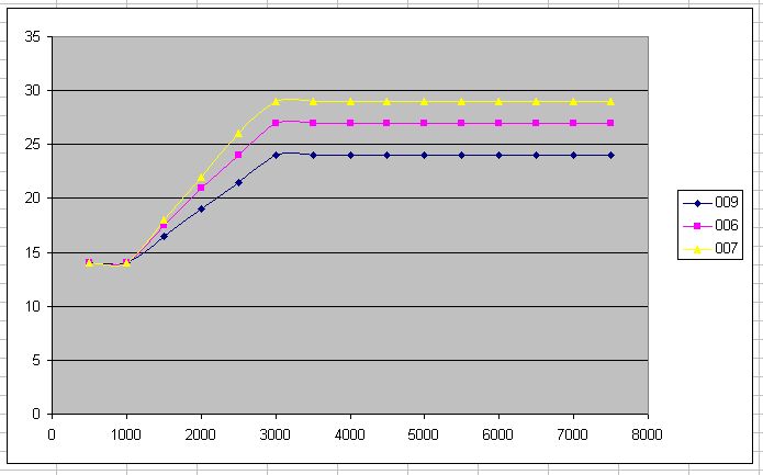

These were the three full load ignition curves, adjusted 1 degree.
Peter, What was the best final adv and power combination? i assume that your engine was a 2L one? although being that they both run the same cylinder heads and c.r, that the advance will be similar? also what engine management do you run? as i am looking to get some in the near future,
