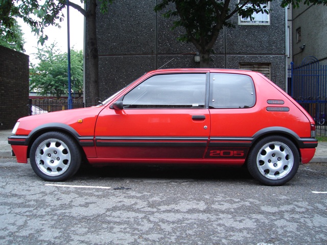

Well when i wanted to change the look of mine i used some halfrauds black vinyl bumper paint.
Worked a treat, even tho i used about 4 tins of the stuff.
Turned it from
http://i42.photobucket.com/albums/e336/ery...s/Picture32.jpg
too
http://i42.photobucket.com/albums/e336/ery...ns/3fb39c08.jpg
http://i42.photobucket.com/albums/e336/ery...ns/STA70015.jpg
Worth the effort imho.
