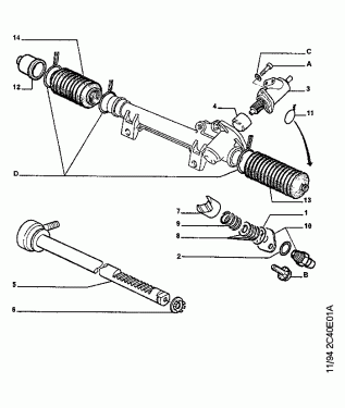

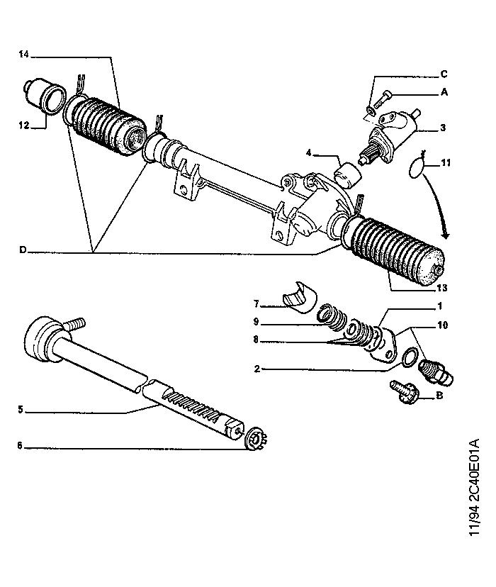

I'm going to be doing this very soon too and was looking at these pictures. I know its also covered in the hayned manual.
KaspaCti
I had a look at those as well, the problem I think I'm going to have is getting the new gaiter over the stud seen on the end of the rack section shown as No 5 in the second picture. I've been trying to remove the stud this afternoon but it doesn't want to budge :lol:
