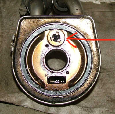

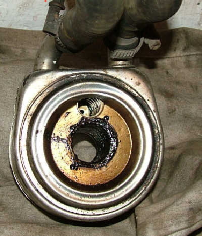

ok i think i need to dig this up as its not part of the filter and i'm finally going to get to work on the car this weekend :blink:. The remote filter housing has the main part that the filter screws onto. If you look directly at the housing then there is a small hole at the top left. This has a spring and other metal bits hanging out. I am planning to just pull it all out and fit the new filter.
If the bit you are asking about is what I think it is, imo its a seperate non return valve that holds some oil in the pipes.
Pictures below are from oil filter side & pipe face side with the spring valve I think you mean below.
Graham.
Batfink
that would be it! Its basically fallen completely apart
Batfink
do i need this part? should I be finding a replacement or should I not be worried?
It must be fitted for a reason & I think you might be in luck if you want to fit one as I've found one yesterday on a spare exchanger unit.
