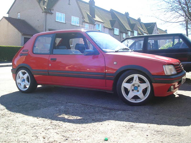

duncs 0 Posted May 3, 2007 here is a pic of what £500 buys you up here and a pic of the 205 its going into having to sell the 309 can i swap that huge inlet manifold for an mi or gti-6 one ? new one http://i122.photobucket.com/albums/o257/duncs_01/dunc011.jpg http://i122.photobucket.com/albums/o257/duncs_01/dunc010.jpg new home? http://i122.photobucket.com/albums/o257/duncs_01/dunc006.jpg http://i122.photobucket.com/albums/o257/duncs_01/red2.jpg Share this post Link to post Share on other sites
