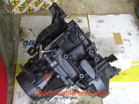

pugman211 0 Posted April 22, 2007 Hi guys, i need to replace my BE1 clutch cable with a BE3 (thats what came with my Mi engine). But i think theres a bracket missing off the gearbox as there only appears to be the clutch arm present. Basically as u look down at the gearbox, towards the bulkhead (on the back of the box) is the selector arms, then on top is the breather, then infront of that is the clutch arm. But how do i tell if its a push type or pull type???? at present, clutch arm is really close to gearbox casing (i.e, near enough parallel). when u press the clutch will this move towards the bellhousing or towards the gearbox??? I know i have to change the pedal in the car as well, and im gonna probably buy a self adjusting cable unless advised otherwise. any help will be great thanks Baz Share this post Link to post Share on other sites

pug_ham 245 3 Cars Posted April 23, 2007 The clutch cable end just fits into the gearbox casuing on the Be3 so there is no obvious end stop like on the Be1 box. Graham. Share this post Link to post Share on other sites
pugman211 0 Posted April 23, 2007 Nice one Graham. i'll be sure to look for that later today! Share this post Link to post Share on other sites
