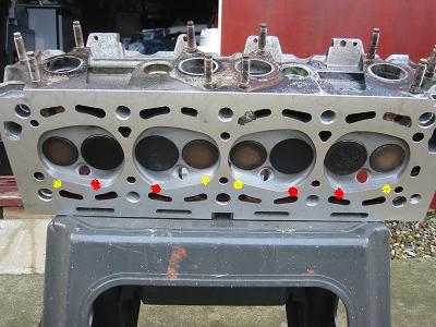

Can anyone tell me why the valves are Exhaust inlet inlet Exhaust Exhaust inlet inlet Exhasust in order rather than Exhaust inlet Exhaust inlet Exhaust inlet Exhaust inlet or vise visa?
Bit of head blagging question so the picture might help
I was woundering if it was pug been tight and allowing the two middle exhausts valves to share the same exhaust manifold hole? Or is there some thing else? Such as heat / flow involved?
Also are most 8's the same? Cheers Andy

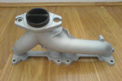

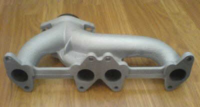

No honest idea why but the valve order is probably like that to make it easier & cheaper to manufacture the manifolds but it does seem a fairly common practice on 8v heads.
The exhausts don't strictly share a port on the exhaust manifold but they do use the same branch. They have a dividing wall between them for approx 2" inside the manifold.
If you want cheap, check the Mini cylinder head.
Only two inlet ports & three exhaust but these are well know for having poor manifold designs & a three branch downpipe & alloy inlet can make a whopping difference.
Cheers Graham, I did already know that was just been blonde for a moment but on the head pictured from my turbo engine it has less studs on the middle ports (4 for 2 ports as instead of 3 for the end ones) so wounder if its just cheaper.

for starters it would look odd as you'd have an inlet on far left and exhaust on far right which would make it assymetrical. also it makes sense as you have two inlets nestled together rather than to hot exhaust pipes on either side. not seen an 8v laid out any other way
correction apart from hemi heads and twin cams...! its a bathtub thing!

id agree wirth veloce it would keep the inlets much cooler having two together rather than 1 between 2 exhaust ports
