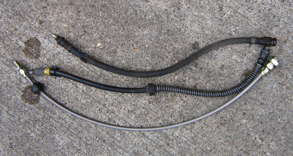

Higgy 0 Posted March 18, 2007 The GTi-6 (well Xara VTS) flexi's are fine if you can find a suitable fixment to the inner wheel arch bracket. I was using flexi lines initally as my 205 ones were too short, however the method of fixing these hoses to the inner arch bracket is different from that of the 205. The bracket I am on about, is where the rigid pipe meets the flex. Higgy. Share this post Link to post Share on other sites
Higgy 0 Posted March 18, 2007 You can see here: Top - standard 205 Middle - Xara VTS Looking at the right hand side you can see the different fittings. Share this post Link to post Share on other sites
Miles 331 1 Cars Posted March 18, 2007 The 306 hose will be long enough, any 306 with vented disc's use the same hose it's just the fitting as Higgy's said but the solid line will screw into it, Share this post Link to post Share on other sites
