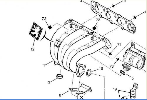

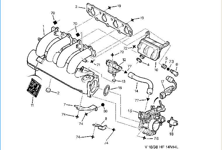

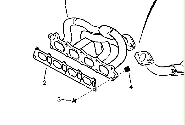

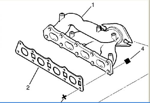

Bam 0 Posted March 20, 2007 here are some infos: xu10rs 120kw (gti-6/s16) inletmanifold: TB diameter: 63mm / 70mm xu10j4r 97,8 kw (406 2.0 16v) inletmanifold: TB diameter: 48mm / 54mm xu10rs 120kw (gti-6/s16) exhaustmanifold: xu10j4r 97,8kw (406 2.0 16v) exhaustmanifold: the 306 xu10j4r inlet manifold looks much different to both. valves xu10j4rs inlet: 34,10mm (!) exhaust: 30,xxmm (!) xu10j4r inlet: 34.60mm exhaust: 29,60mm valvestems on both engine: 6mm camtiming (info from search) RFV: 196°@1mm / 7.90mm Lift RFS: 215°@1mm / 10.00mm Lift inlet/exhaust duct-cross section ??? s16 block has a pistionbottomcooling. ECU gti-6//s16: magnetti marelli 406 2.0 16v: bosch any correctionsuggestion? cheers mik Share this post Link to post Share on other sites
