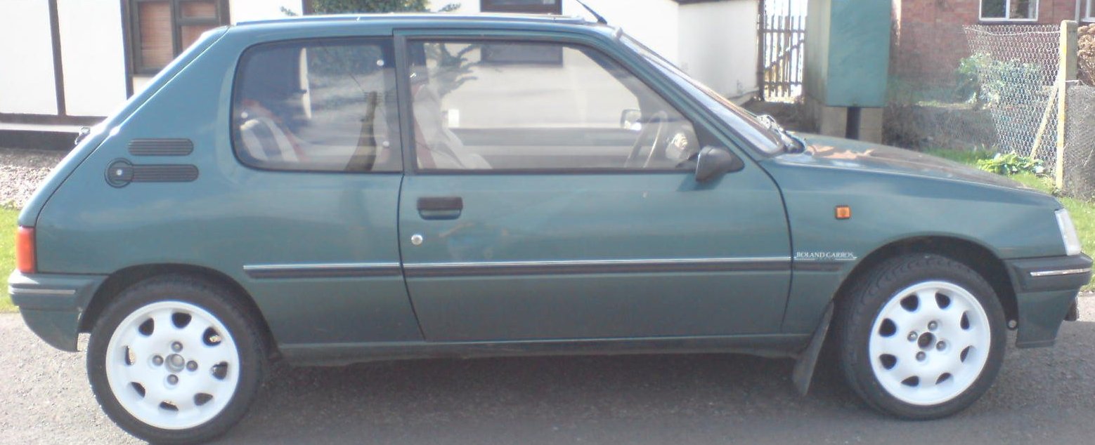

well as we dont have acess to a unit at the min ive settled with doing the wheels with rattle cans, and to be honest for a rush job before fast show so far its all going well. See what you think.
cheapthrills
^^^nice job^^^
