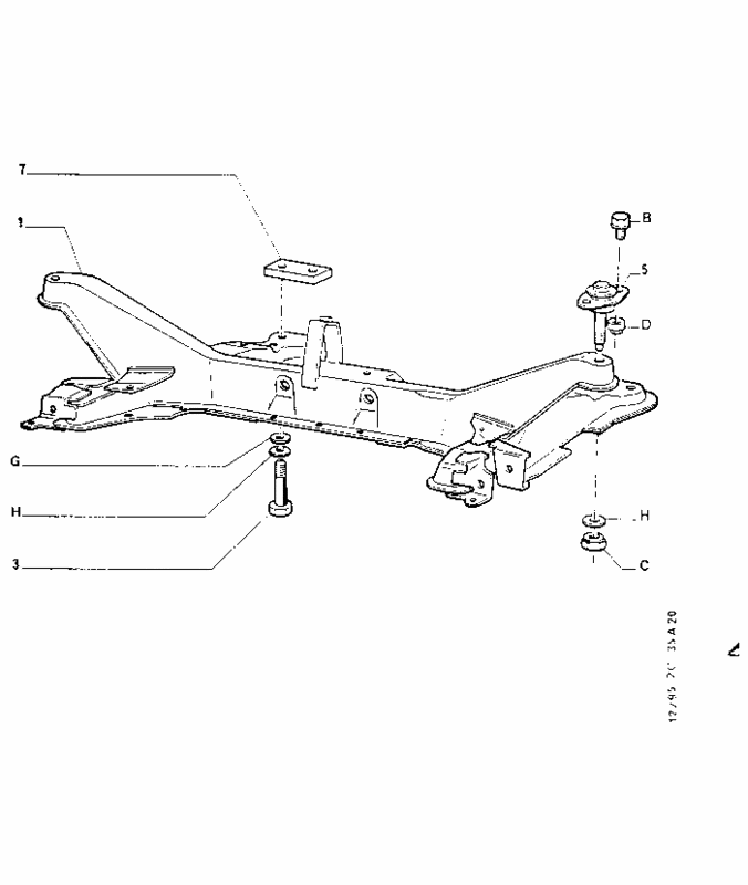

BERTMAN 40 1 Cars Posted March 15, 2007 what size nut and washer do i need to keep my subframe held up... http://i77.photobucket.com/albums/j73/bert...delsubframe.gif parts C and H on the diagram (bottom right of pic) keep ya answer clean!! Cheers Lee Share this post Link to post Share on other sites
B1ack_Mi16 67 Posted March 15, 2007 what size nut and washer do i need to keep my subframe held up... http://i77.photobucket.com/albums/j73/bert...delsubframe.gif parts C and H on the diagram (bottom right of pic) keep ya answer clean!! Cheers Lee M10 Share this post Link to post Share on other sites
pug_ham 245 3 Cars Posted March 15, 2007 9C 6939 29 01 SELF LOCKG NUT 10X150-12,6-17 9H 6962 11 01 FLEXIBLE WASHER 10X21,3-1 http://www.stuartmcguire.co.uk/pug/GB/205N/3/35A20A.HTM Graham. Share this post Link to post Share on other sites
BERTMAN 40 1 Cars Posted March 15, 2007 cheers, i was lookin for that website lol... i only had the picture... Share this post Link to post Share on other sites
