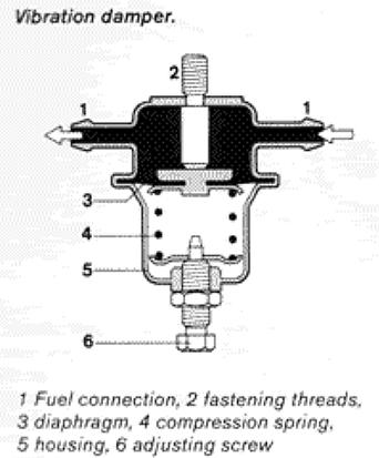

I was reading through the BOSCH Motronic information manual thing, and came across the 'vibration/pulsation damper'.
I left it off when I transplanted the Mi16 into my 205. Do many people use it?

Here is what BOSCH say:
Fuel filters 'should' stop them getting blocked up.
I can't see how external pump makes a difference. I think the BX has a pump in the tank, and I guess it also has a vibration damper for its Mi16 engine.
