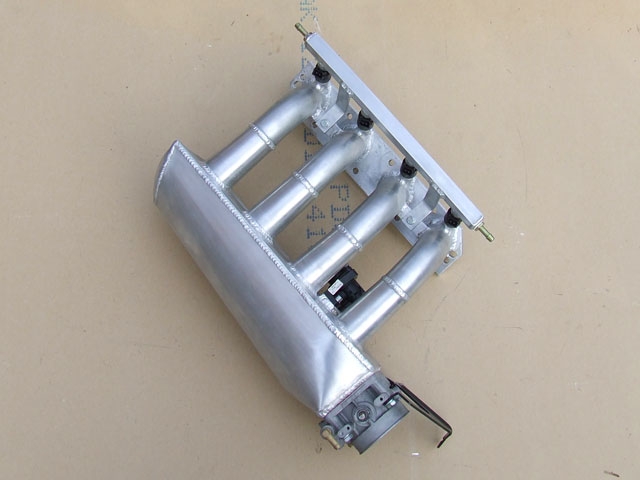

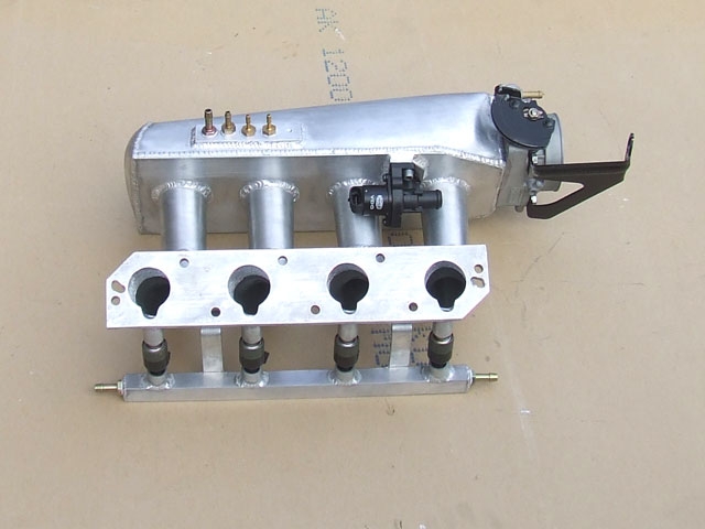

From Pieter Oonincx at http://www.dp-engineering.nl/EN/
  Quote
Let me start with thanking you for your interest in our products and services!
Yes, we do produce (build on order) sheet aluminum performance intake manifolds for the XU 8v engine. It comes with a 70mm throttle body (70mm plate), tapered velocity stack runners, fuel rail, throttle cable bracket and connections for idle air speed and various vacuum sources. The plenum volume is matched for the 1998cc engine and the runners for torque up in the rev range.
Price for the manifold (including parts mentioned above);
Wait for it ....
:wub:
Price including VAT 1.300,67 - Now my guess is that is in Euro's (kind of hopin too!)
Rex, if you can make those, then I'll be the one buying the rouge and possibley a whole Horse :wub:
It's part of the reason the standard engine makes so much torque and low revs to do with the standard intake manifold !
Im loving my new stamp vented boonet BTW, open the window and listen to the air filter sucking away and the compressor stall reverberating back through
it :wub:
(The first picture I posted of that manifold is on Boeseturbo's engine in Germany)

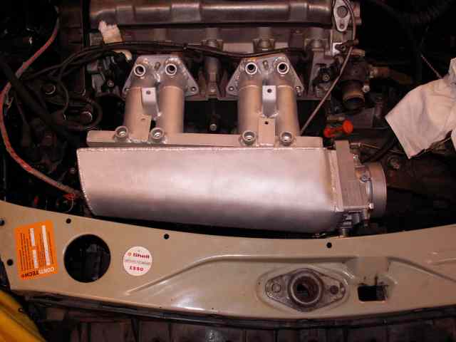

whizzer71
Hey guys thats not too discimilar to the old BX 1.9 8V / 405 SRI inlet manifold assy (minus 4 injectors though) ,(Avail at most good scrappies throughout the uk) !,It was mentioned to me about using the XM 8V 2.0i manifold but its been so many years since Ive seen one of those old donkeys let alone worked on one that Im stuffed if I can remember what they look like ! (manifold that is not XM !) :wub: .
Tris
:wub:
Edited by whizzer71
sonofsam
lol
Yeah I remember reading a post by Lee (jacobs53) about the XM manifold, has twin butterflies supposedly!
Their's also topics on how you can't use xu9 (205) manifolds on this engine as the injectors fire at completely the wrong angle :wub::wub:
Dont know about the BX/SRI ones though..
DP is it then :wub:
rex
Thanks for the replies fella's.
I had a twin butterfly assembly that I welded onto the XU9 inlet manifold from a 405 SRi. After, I went on to a single throttle body of a 635i with the airflow meter but it was all huge amounts of work.
Sam - do you know where the 70mm throttle body comes from? Will it run on the existing ECU?
I can't see a lot of problems making it other than the time and the material - but it would be nice to have one here to make an exact copy.... :wub: Anyone fancy shelling out 1300 euros for me to get one for next to nowt? :wub:
