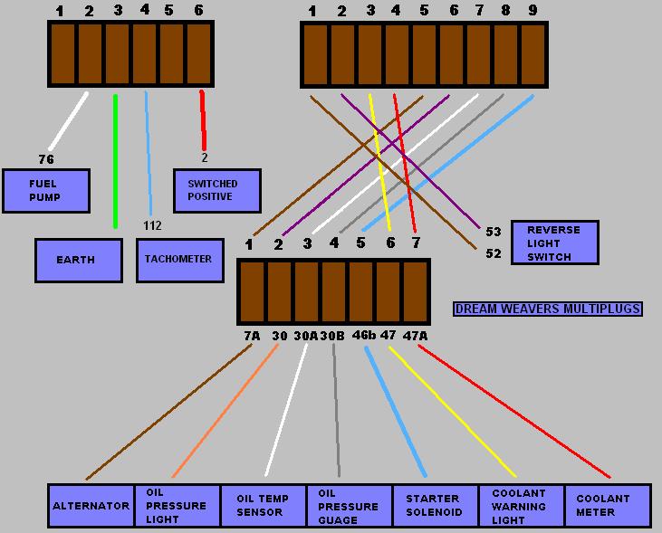

The underdash plugs are the same on all Phase 1.5 and Phase 2 cars, with the exception that the starter solenoid (46B - blue) and ignition live (2B - red) are swapped between early and late cars and hence needs to be checked ;)

I've edited the original CTi diagram to include wire 112 and I've changed wire 25a to 32a (I'm still not sure where 25a came from :blush: maybe I'm going mad); I've also deleted the original picture.
G Reg CTi
Graham: On your picture, what does wire 47B do on the 9 pin? I thought that would be wire 46 :D

112 is the one you need.

2a and 32 are they a switch live from the ignition???
as i was thinking of using the 2a as my lambda live for my gti-6
that be ok????
yes, they are switched live, you use it to power the injection relay, lambda IIRC comes from the relay.

Hey, anyone know what ampage of wire I need to replace the blue one that runs to the Starter Solenoid?
Many thanks
Edit: a more extensive search revealed that its 30A that I need :D

Right, I'm fairly certain now that I have got the wiring correct.
Could a mod put this attachment on the first post as well as this one so that people don't need to sort through all four pages to find it? Cheers :lol:
