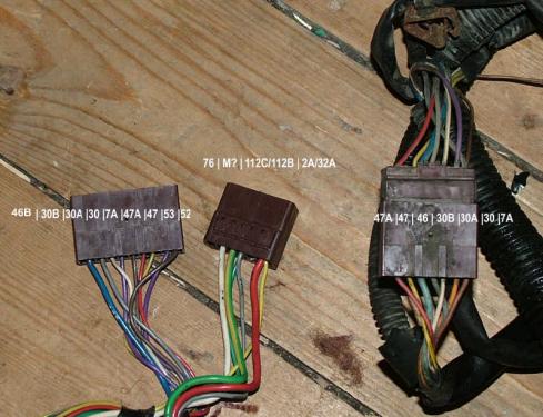

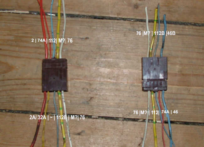

Pictures of the under dash & engine bay plugs from my J reg 91 car & other under dash spare plugs I have below.
I have now seen four looms for the underdash plugs & all but one have the coil wire (2A) & 32A coming out of the same pin of the six pin plug from under the dash.

I've edited the original CTi diagram to include wire 112 and I've changed wire 25a to 32a (I'm still not sure where 25a came from :wacko: maybe I'm going mad); I've also deleted the original picture.
G Reg CTi
Graham: On your picture, what does wire 47B do on the 9 pin? I thought that would be wire 46 :unsure:
it should (& soon will) read 46B. :wacko:
Graham.

I've been wiring another MP3.1 conversion up last week & I think if you have a car with the plugs above that include wire # 74A on the car side of the loom then you should be able to connect the K light wire from the ecu straight up to here & with no extra work except a bulb in the clocks you should have a working K light.
I had on this car (J reg) & will do the same on mine (H reg) this week when I've got chance. I'll post again to say if it works on mine.
Graham.
