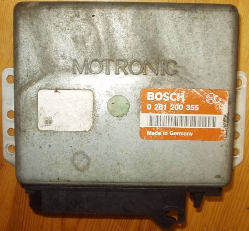

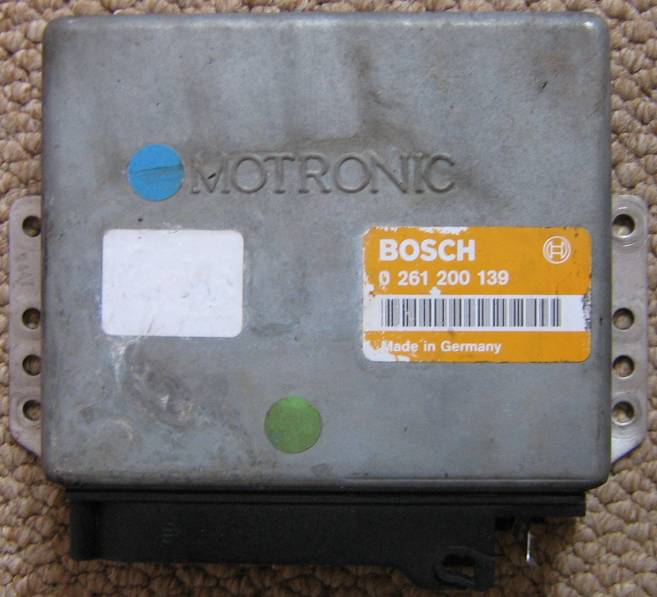

Here are pics of my Mi16x4 ECU's
Mi16x4 2-ROW ECU :-
Mi16x4 3-ROW ECU :-
(oh I did a rev-limit test and it was 6900rpm, but I know my dash gauge is out).
Higgy.
Baz
I have a couple of 3row ECU's. they're '355's too, i don't think they're 4x4 specific tbh.
KRISKARRERA
Both my 2wd Mi16 were/are identical to those pictured above and both rev to 7400rpm on the 405 rev counter.
