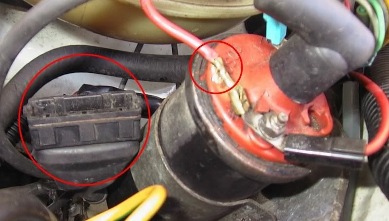

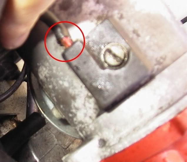

axnutty 10 Posted February 7, 2007 (edited) Right ive had a good look at this today and have discovered the following...thanks for all the sugestions btw. POSSIBLE CULPRITS: 1./ The little metal clip that holds the plug to Ignition amp is rusty and doesnt retain the plug very well...most likely culprit...also noticed the poor LT wire connection at the coil itself Pic 2./ The wire coming from the distributer itself is broken - could be causing it, if not now certainly in the future as itll corrode nicely now no doubt Pic 3./ I have moved the fuse/power block on the slam panel to accomodate the AFM (KN filter conversion) and its left the little power lead from the battery rather taught which cant be doing any good. Any further thoughts or suggestions appriciated Ill update with outcome later on. Edited February 7, 2007 by axnutty Share this post Link to post Share on other sites
