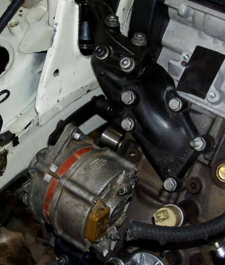

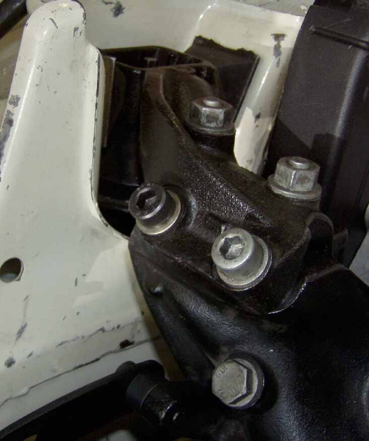

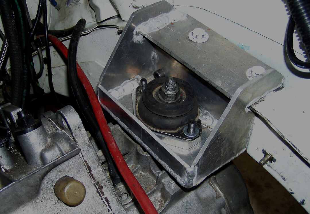

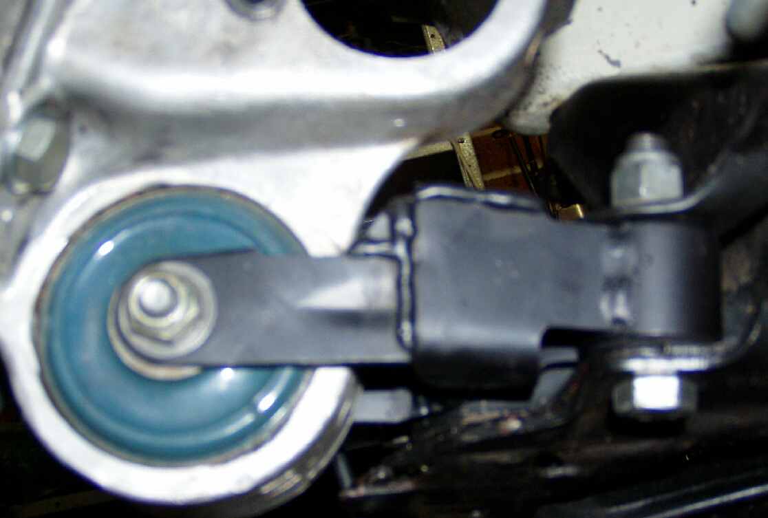

I have the same setup, S16 block, 1.9L head and TB's. I solved the problem by dropping the engine 15mm. It's hard to see from the pics., but I had the RH engine mount remade 15mm lower in overall height. I fabricated a new gearbox mount, but actually went too low and had to add a spacer. I also cut and shut the bottom mount so it was 15mm lower.

As lowering a car in theory increases the angle of the wishbone, does lowering the engine balance out such a change when lowering the engine ?
Plus you have the lower COG benefits, and weight saving on the ali mount ;)

The wishbones are attached to the subframe so lowering the engine won't affect them, but the driveshaft angle will be affected slightly. However it wont balance out any changes made by lowering the shell via shortening the strut height, it will exaggerate them.
