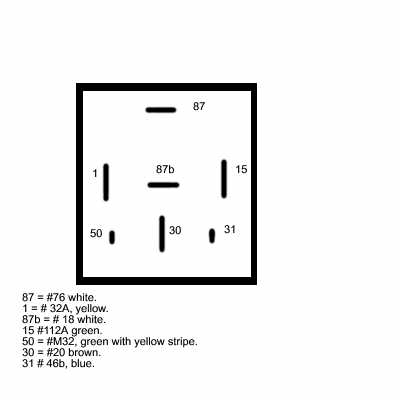

blackpug 0 Posted January 12, 2007 Does anyone have a wiring diagram/can tell me where each wire off the relay goes? I'm having a problem with the relay itself not holding open, and not sending a signal to the ecu(?) i think. Share this post Link to post Share on other sites

pug_ham 245 3 Cars Posted January 14, 2007 Relay pin & assoioated wires in attached picture. Graham. Share this post Link to post Share on other sites
