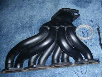

sutol 0 Posted January 9, 2007 Had a search and can't find any info. Didn't know until today that there are two types of 8 port manifolds, one cast and one tubular. My motor came without so I'm scanning eBay for one and need to know which one is best..TA.. Share this post Link to post Share on other sites

pug_ham 243 3 Cars Posted January 10, 2007 thought they were cast tubes Doesn't look very cast to me. More tubular as its welded. What head / engine is yours as the stud pattern is different & they aren't interchangable. Graham. Share this post Link to post Share on other sites
petert 580 Posted January 10, 2007 As Graham said, the 1.9L XU9J4 manifold is tubular welded, with 9 studs, whilst the 2.0L XU10J4 manifold is cast iron with 10 studs. Completely different animals and impossible to swap. Share this post Link to post Share on other sites
sutol 0 Posted January 10, 2007 As Graham said, the 1.9L XU9J4 manifold is tubular welded, with 9 studs, whilst the 2.0L XU10J4 manifold is cast iron with 10 studs. Completely different animals and impossible to swap. Phew !!! nearly bought one. best check. Mine is an all alloy block , just been out to check and the head has nine studs so it looks as if I'll be bidding on that one in the picture, yes ?. Give us a guide on price as I've just been offered one from a scrapman for 70 quid and he didn't say which one it was ! Share this post Link to post Share on other sites
