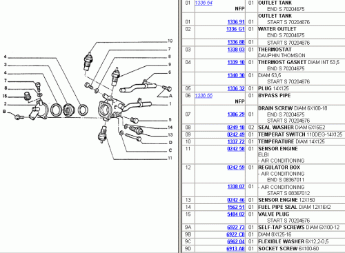

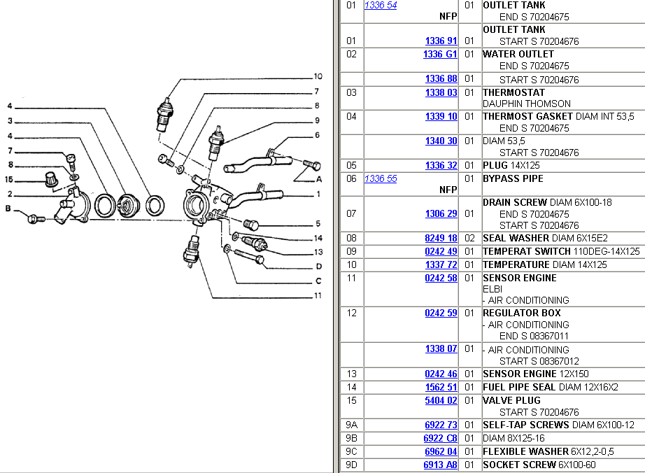

I'm not sure what the difference is between the 2 versions listed, but the earlier one is no longer available anyway.
